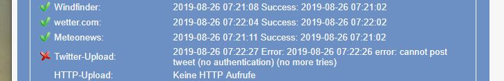

I get the following message with regard to the update of 25-08-2019:
Error: twitter registration failed: openssl: can't resolve symbol 'COMP_zlib_cleanup'
Error: Twiter feed from Meteobridge not yet authorized
And this message appears in the Weather Network status:
Twitter upload:
2019-08-25 21:09:55 Error: 2019-08-25 21:09:23 openssl: can't resolve symbol 'COMP_zlib_cleanup' openssl: can't resolve symbol 'COMP_zlib_cleanup' error (215): "Bad Authentication data." (no more tries)

Thanks for spotting this bug. It is a side effect of the new openssl lib used. I made a fix with just released update. Please reboot and give it a try,

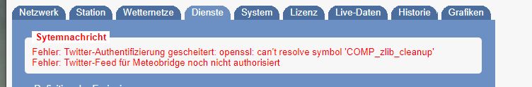

When I'm on "Request PIN" button then the next problem comes then this message:
Error: Twiter feed from Meteobridge not yet authorized.
Meteobridge 4.1 (Aug 26 2019, build 13110), FW 1.4 installed, twitter problem is not solved.

Re: Twitter Error
please reboot, there is a new version online.

Re: Twitter Error
please try again.

Thanks Boris now it works again with version Meteobridge 4.1 (Aug 27 2019, build 13116), FW 1.4
