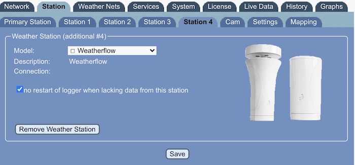

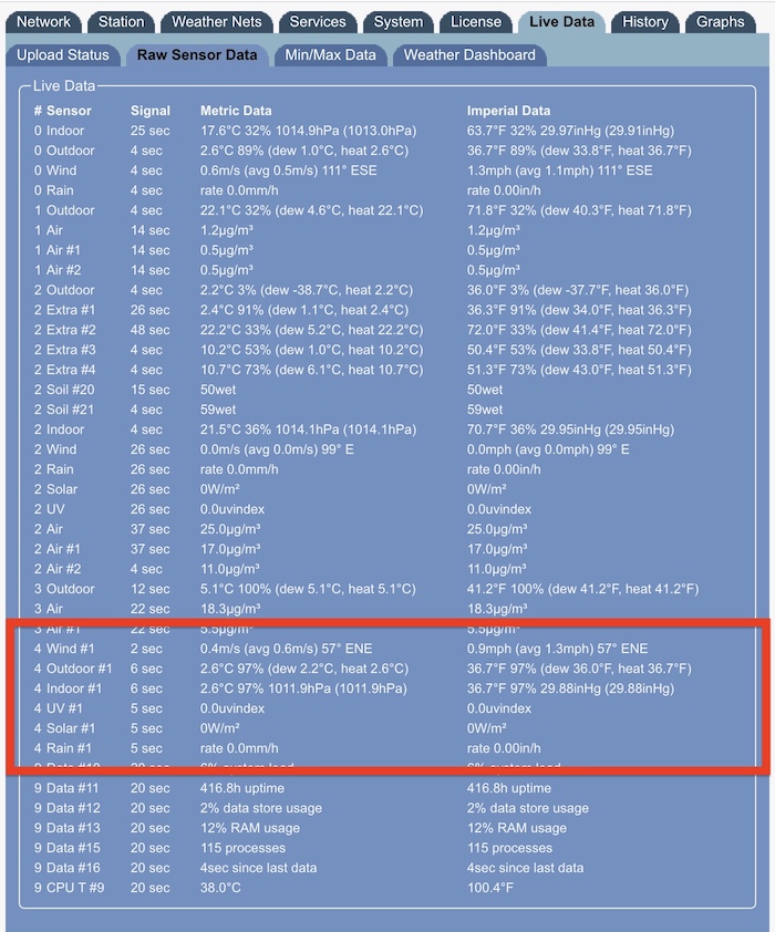

All devices must be on the same IP-network as the Meteobridge.
So make sure that the tempest is not on another accespoint as they sometimes block traffic to other parts of the network.
I have the MB-RPI I use for testing on the LAN but also tested with WiFi
Both the Tempest and the Sky-Air are connected as station #4 via WiFi
You can not select the IP-address as the MB listens for traffic from those devices.

And he Meteobridge keeps humming along. No problems there. If you connect two WF/tempest devices you get double the physical sensors.
And you can map them around as you wish.
Even added UV and Solar to the Davis VUE.
So it should work at your site also. Probably a WiFi-access point network which does pass the UDP packets.
