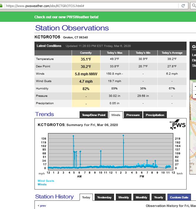

Problem Statement

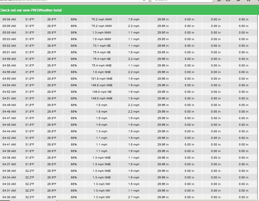

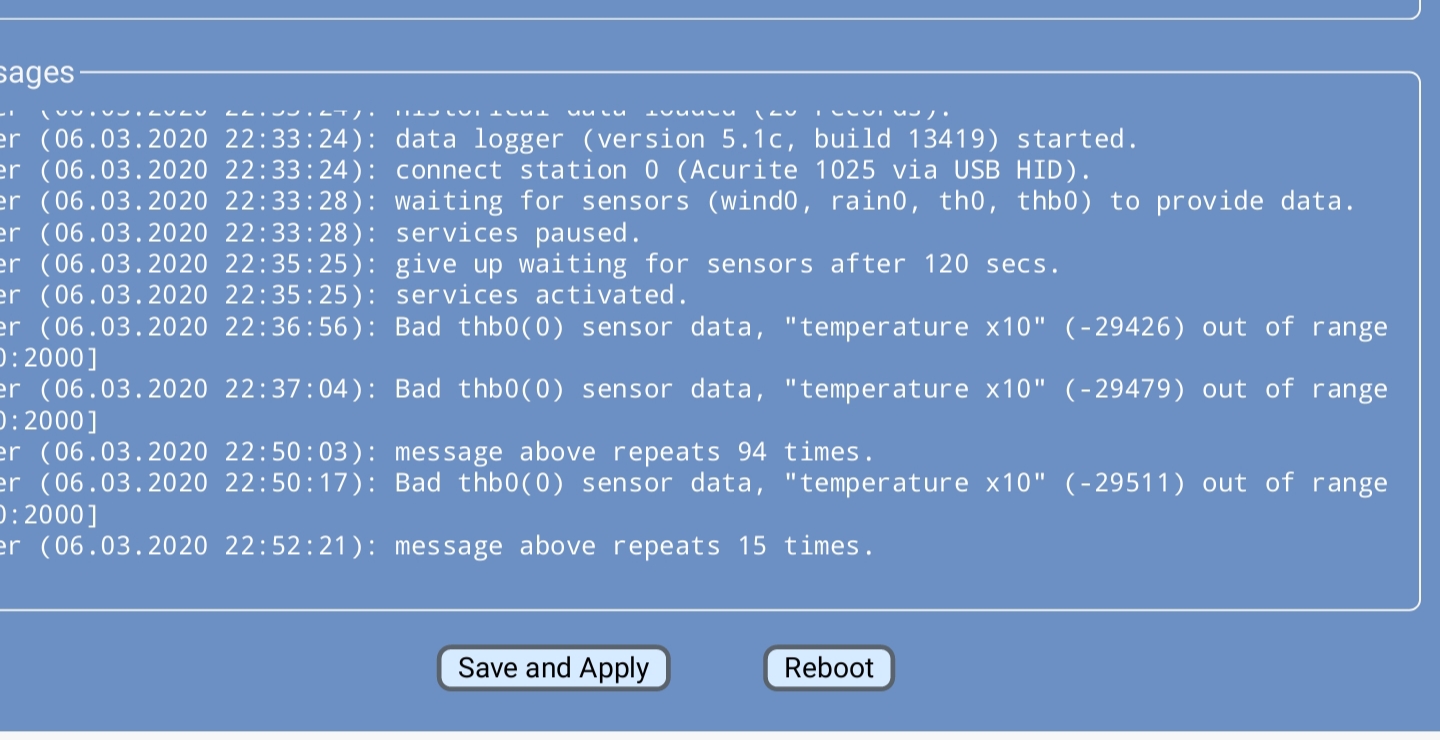

So I just got Meteobridge running, but I'm running into a problem. The station wind data keeps getting skewed. When a low wind speeds like 1.4 MPH gets changed to 140-150mph (242.7 kmh) and then get sent to all of the weather sites. The decimal keeps getting shifted around about 3 to 10 times a day till error detection shuts it down. The weather display has internal memory and when downloaded doesn't show the wind data spikes errors. The station signal strength is very strong so I'm not sure whats going on. Is 4.3 the correct version of the software?
The Hardware
I'm running a TL-MR3020 V1 with 4.3 fw 1.5 with a Acurite color display 1036 with a 5in1.

the data
the data
wind data 2.JPG (108.51 KiB) Viewed 12808 times
