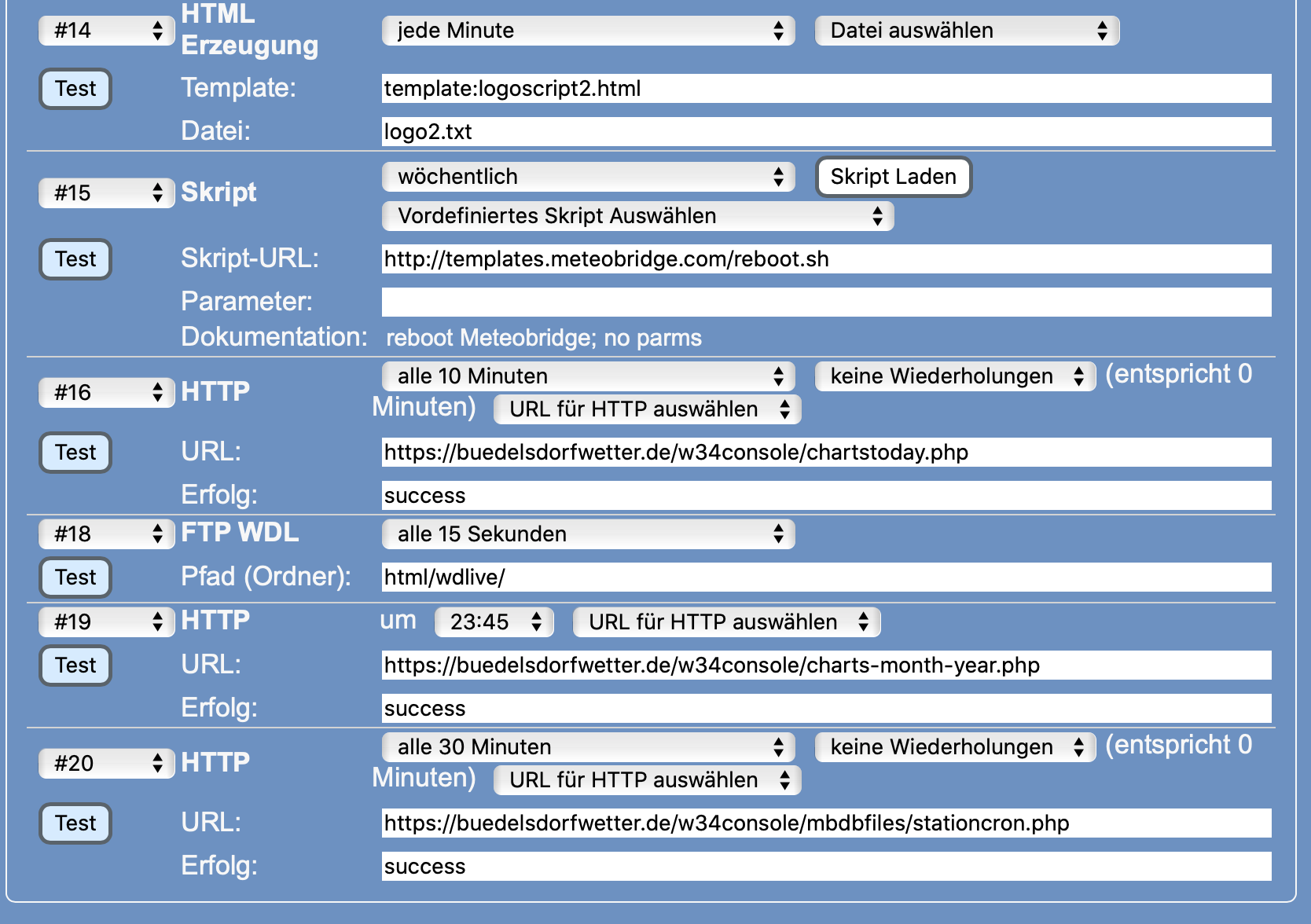

Have a problem on my NanoSD: Since a few days there is always an HTTP error on the live screen of the Nano SD for the HTTP requests on my webspace. I have installed the weather34-template on my webspace and this must "feed" with 3 http-requests.
one or all of this 3 (numbers 16,19,20) requests produce an error-message, but it seems to be working for the assumed template.

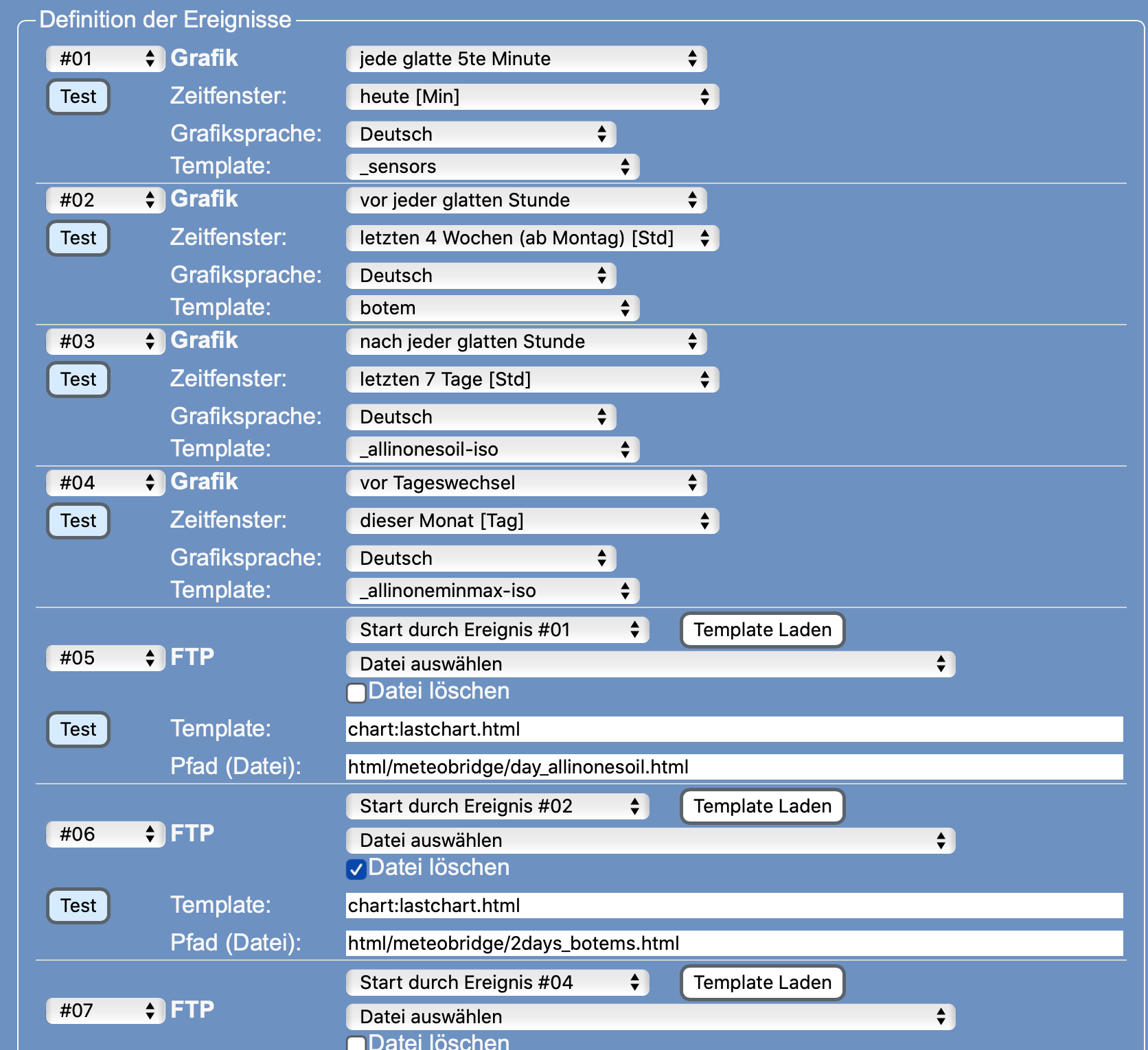

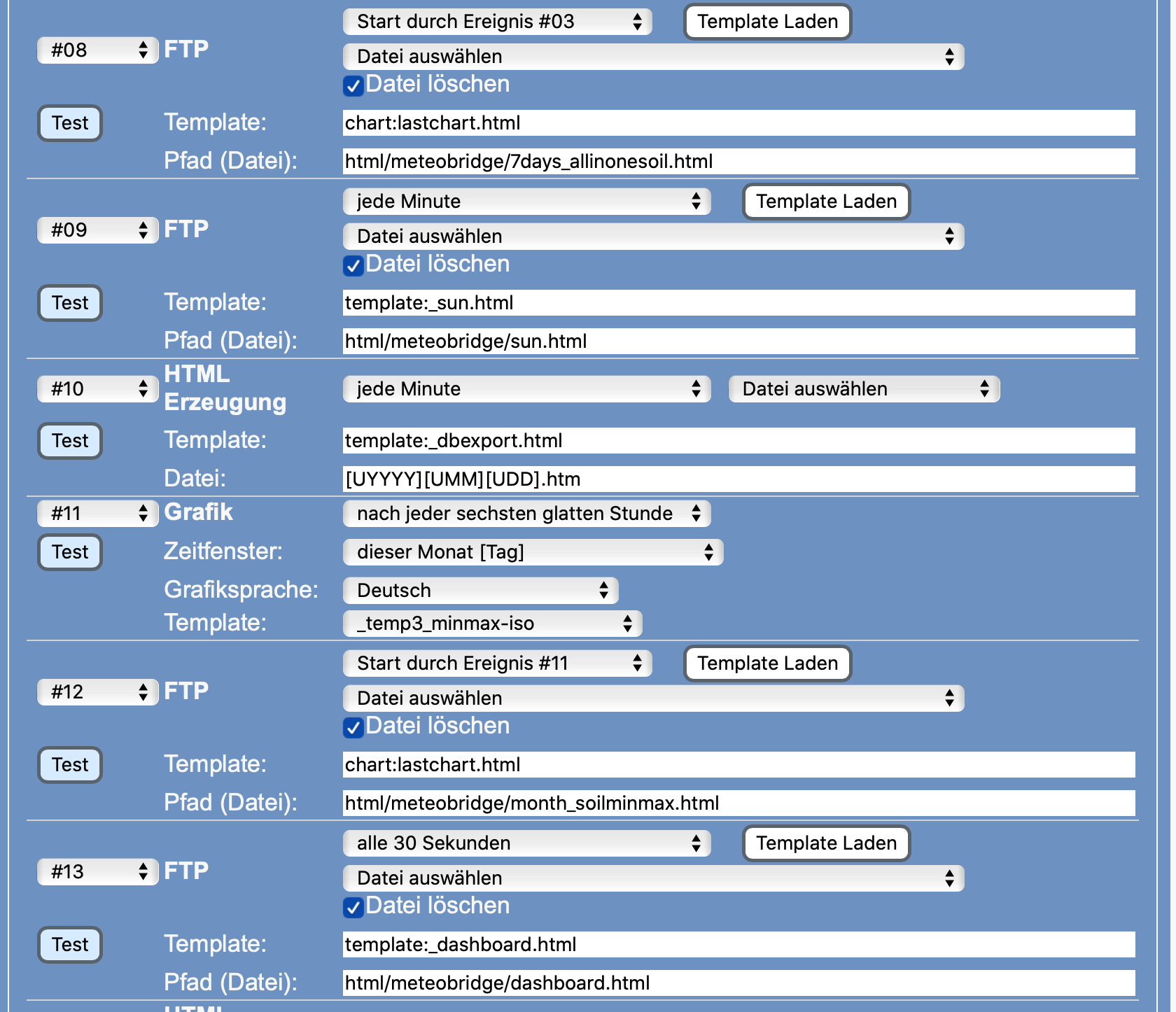

I have a lot of services running (19 from max. 20), here are screenshots from all defined services:

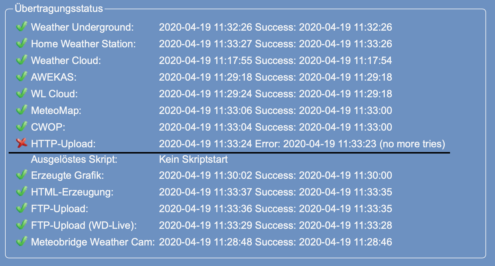

On the live-screen of meteobridge:
Bildschirmfoto 2020-04-19 um 11.33.46.png (245.45 KiB) Viewed 1669 times
This error message remains as long as I leave the http-requests active, if I switch them off, the error message has disappeared. Apparently, the http-requests are still executed, because the requesting template (weather34-template) contains all graphics and forecasts, which are requested with it.All my other uploads to my webspace works without some issues..
A reboot of the Nano SD and a reinstallation of the template on my webspace don't change anything...
Has anyone an idea, how I can fix this error-message on Meteobridge-livescreen, this would be great!

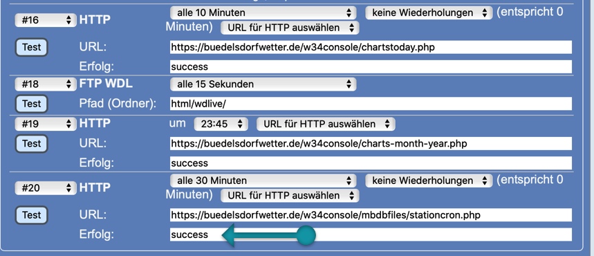

try removing/deleting the word "success" ..

Thanks, I will try it..
it would be crazy if it was just that word... Then what is this field for anyway?
:-) Yes, that was actually the cause, incredible! The error was gone! I had searched hour by hour to find the reason, but I would never have come across this cause! :-)
