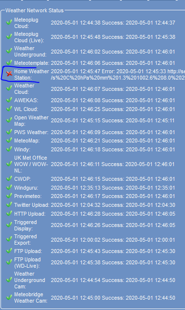

your meteobridge pro is having some problems outputting the data string
since this morning my two templates are offline my meteobridges work for data reports I have the following log

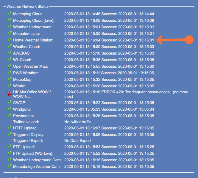

my meteobridge connects to your server correctly as per screenshots shown.
http://seremange-meteolive.franceserv.com/pws/index.php using my meteobridge data and is running ok so it is not a template issue hence opening up this thread .

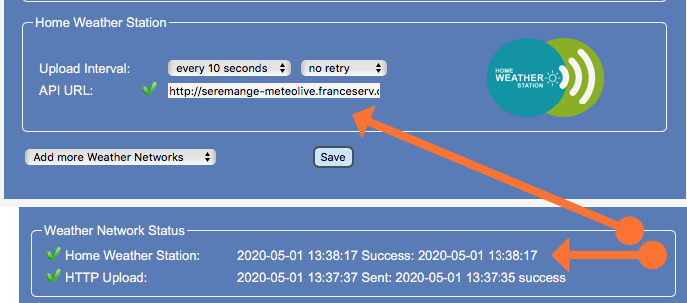

I just entered my test folder url into your meteobridge pro with the remote login you just sent and it is all working with no errors for homeweatherstation
screen shot from your live data

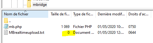

your code in a MBrealtimeupload.txt on my server generated by your meteobridge pro , I don't own a meteobridge pro but you can identify it by the
CARAMBOLA2 and the 13:22 which is your data . so you need to look closely at your server for any changes .this is not something I can look at when it is at server level
01/05/2020 13:22:01 11.9 83.0 9.1 1.3 2.7 69.0 0.0 8.0 1002.5 326.0 2 m/s C hPa mm 0.9 1002.8 8.0 291.0 6.0 22.2 45.0 10.9 11.6 12.2 20200501125141 8.1 20200501080124 2.7 20200501075634 6.3 20200501103041 1003.5 20200501003937 1002.2 20200501100039 4.3 13444 4.0 CARAMBOLA2 -- 1.9 9.8 292.0 336.0 0.0 9.4 20200501125327 6.7 20200501080124 10.1 20200430024943 13.5 20200418132225 -10.8 20200325143059 5.3 94.0 20200501074154 81.0 20200501123745 9.4 20200501125327 6.7 20200501080124 12.1 82.0 9.1 22.2 45 1.2 1.3 -- -- -- -- -- -- 886.0 1139 13.8 20200430141023 9.3 20200430105932 12.2 20200501125141 8.1 20200501080124 25.1 20200409165926 -2.4 20200122081856 7.2 20200430081302 6.3 20200501103041 17.0 20200210050627 6.0 8.0 20200501000006 291.0 20200210025631 886.0 20200501120315 856.0 20200430121406 886.0 20200501120315 1030.0 20200428133347 20200501120747 4.6 20200430121608 5.3 20200501120747 6.3 20200428132555 6.5 20200430105256 2 12.0 20200501104542 39.9 20190725164555 -11.7 20180228061500 24.0 20180726171230 -17.0 20180225150510 21.5 20190929223929 1005.4 20200430000038 1001.0 20200430171439 1003.5 20200501003937 1002.2 20200501100039 1046.3 20200120104316 986.6 20200227154550 1046.7 20161228092025 921.8 20170622215436 2182.2 9.6 2 56.8 14:40 12:55 03:46 0.9 94.0 20200501074154 81.0 20200501123745 99.0 20200108125643 17.0 20200415165926 92.0 20200430041446 73.0 20200430141943 0.0 0.0 10.8 817.0 -- 11.9 1002.4 2.0 1.3 302.2 9.1 0.0 83.0 8.3 1.0 20161203105058 20161203103431 20161203103746 20161219161634 20200101000048 333.0 25.1 20200409165926 -5.8 20200330080747 _Mostly cloudy and cooler. Precipitation possible within 12 hours, possibly heavy at times. Windy.

weatherist34 wrote: Fri May 01, 2020 1:19 pm something strange here so you need to look at closely server level ,did anything change .

If your MB fails uploading, how can the data file become empty again?
It could be that the mb.php script is doing something before saving the data.
Maybe post a zip of the mb.php script? Mine is years old.
