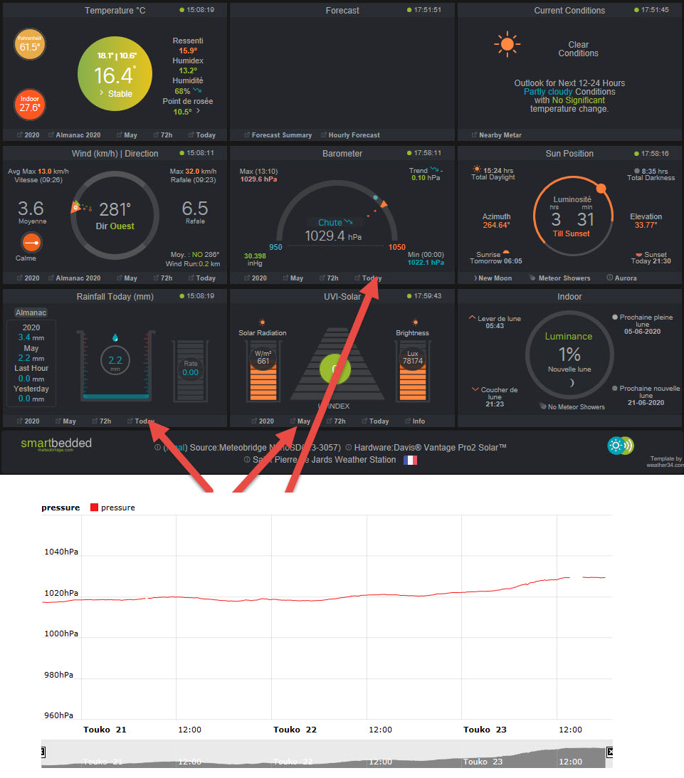

I'm using Wheater34 template on Nano HD. When a chart is displayed (click on the footer of a widget), month is not displayed in the correct language. "TOUKO" is currently displayed (English or French UI) which seems to be Finnish?

Version (Final) Source:Meteobridge NanoSD(4.3-3057) Hardware:Davis® Vantage Pro2 Solar™
Every graph display month to what I think is Finnish or maybe Danish. UI set to English or French does not matter. Touko meaning May

36260 wrote: Sat May 23, 2020 6:14 pm Version (Final) Source:Meteobridge NanoSD(4.3-3057) Hardware:Davis® Vantage Pro2 Solar™
i see thats the internal version in the nanosd the graphs are generated by the nanosd meteobridge software so it is not something i can help with. perhaps Boris can help... also beware that version is using darksky for forecast data it is no longer possible to get an API key for new newer purchases of Nanosd only older users will see a forecast .may be a user(s) can share an api key ?.. sorry i cant help...brian... ps pm if you need an api key i have two keys i dont use anymore..

ConligWX wrote: Sat May 23, 2020 9:19 pm yep, not sure what the issue is, as I dont have "Touko" at all and mine is set to English.
I take it you have go into the menu of that page and setup any "settings" that are needed?
http://ip.of.mb.nano/PWS/easyweathersetup.php
I had the idea to set display language menu to no. Then the bug disappears. Reverting to yes and the problem cannot be seen any more. However let’s say one select English in the menu langage then the language of the month will stay in stay in French whereas it should have switched to English.
