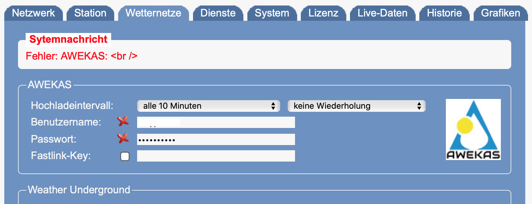

Another special feature has been on display for a few days now:
In AWEKAS an error message is displayed on the weather network page, but the transfer to AWEKAS works fine.

AWEKAS: Reason is an internal warnong message reagrding an SQL statement on AWEKAS side. I made Meteobridge more tolerant to this. Just released update fixes the problem.
