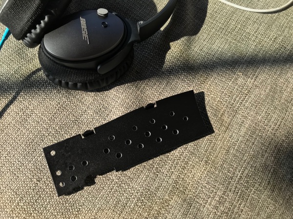

however cheap dirty trick to keep it cooler and allow some better airflow , I bought a spare battery cover DAVIS VANTAGE PRO2 BATTERY COVER (7342.702) a couple of years ago from the USA but you can find them at https://weatherspares.co.uk/collections ... oducts/404
I bought it simply to drill a small set of holes to allow some airflow when the battery cover is in place its just a cheap dirty trick and reduces also console temperature for indoor to a realistic figure .as I said just a crude dirty trick that does the job.

idea was to allow you to have the battery cover in place so you don’t accidentally touch it or the area and enabling some cooling airflow. the led is there for a diagnostic purpose also aid you if you have any issues.to date im not aware of any disabling method. LEDS always run hot but ive not seen that it has impacted anything within the console or nano itself since 2018.
