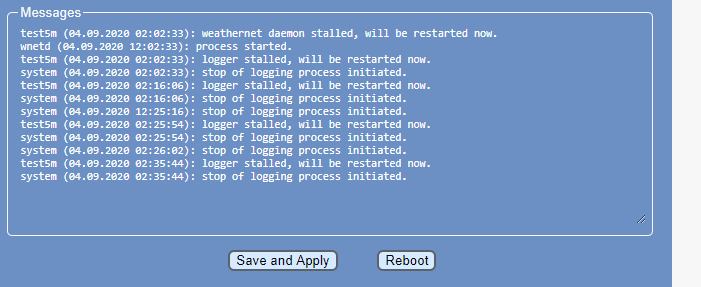

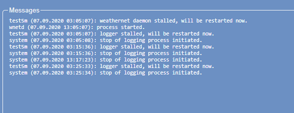

Hi Admin,
I am getting this error
test5m (04.09.2020 02:02:33): weathernet daemon stalled, will be restarted now.
wnetd (04.09.2020 12:02:33): process started.
test5m (04.09.2020 02:02:33): logger stalled, will be restarted now.
system (04.09.2020 02:02:33): stop of logging process initiated.
test5m (04.09.2020 02:16:06): logger stalled, will be restarted now.
system (04.09.2020 02:16:06): stop of logging process initiated.
system (04.09.2020 12:25:16): stop of logging process initiated.
test5m (04.09.2020 02:25:54): logger stalled, will be restarted now.
system (04.09.2020 02:25:54): stop of logging process initiated.
system (04.09.2020 02:26:02): stop of logging process initiated.
test5m (04.09.2020 02:35:44): logger stalled, will be restarted now.
system (04.09.2020 02:35:44): stop of logging process initiated.
Can you please suggeest on this. I have attached some of the warnings. Is that related with this error. Need suggestion to fix this problem. Thanks

- Capture3.PNG (8.13 KiB) Viewed 3399 times
- Capture1.PNG (33.29 KiB) Viewed 3399 times
- Capture.PNG (44.43 KiB) Viewed 3399 times
- Capture2.PNG (23.98 KiB) Viewed 3399 times

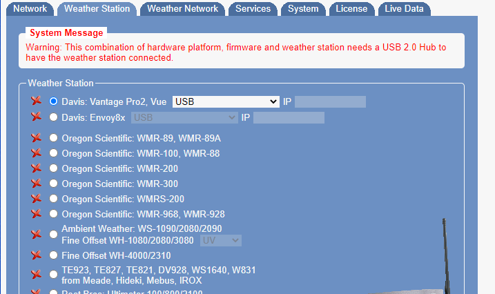

Re: meteobridge doesnot connect to data logger vantage pro 2
Are you using a USB 2.0 hub between your logger and the Meteobridge?

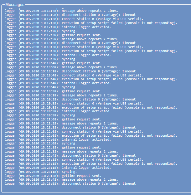

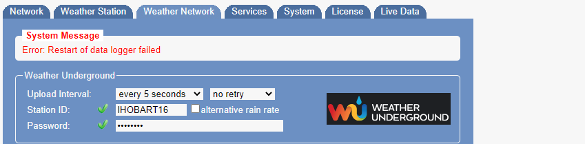

Nope. But Now I have connected to usb 2.0 hub And that error weather station tab error gone. But Now I am getting this error.
- error.PNG (14.79 KiB) Viewed 3363 times
- Restart failed.PNG (20.51 KiB) Viewed 3363 times

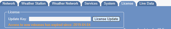

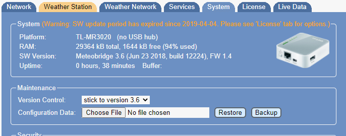

Looks like you are on an older version of Meteobridge. I remember this sort of bug at some point. I recommend a few different things to try in this order.
- Make sure your USB logger firmware is current.
- Try a newer version of Meteobridge than 3.6. Your upgrade license expired April 2019 and you should be able to run up to version 3.8 or 3.9 I think. There may be a bug in 3.6 for your particular setup.
- Try going the other way if 3.8 or 3.9 doesn't work with an earlier version than 3. 6 of Meteobridge (you'll sacrifice features). Maybe skip to next recommendation point if this doesn't produce results you want. I'm listing this for completeness, but I don't think it is a good option.
- Renew your Meteobridge license to give you the latest version and all bug fixes to date, including new features.
You can read about all the improvements and fixes since your 3.6 version here (currently up to version 4.4):
https://www.meteobridge.com/wiki/index.php/Forum

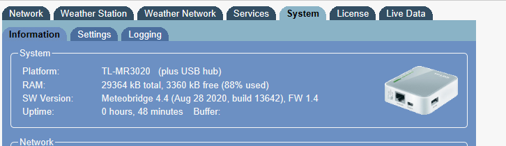

Hi Admin,
I have updated meteobridge license license. But still getting error.
- Current Data.PNG (56.05 KiB) Viewed 3322 times
- updated.PNG (25.38 KiB) Viewed 3322 times
- error1.PNG (63.88 KiB) Viewed 3322 times

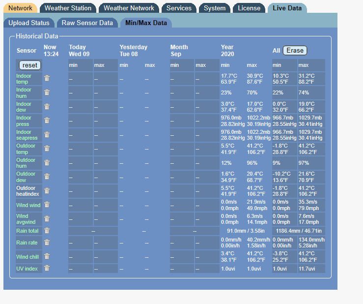

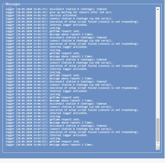

Hi admin,

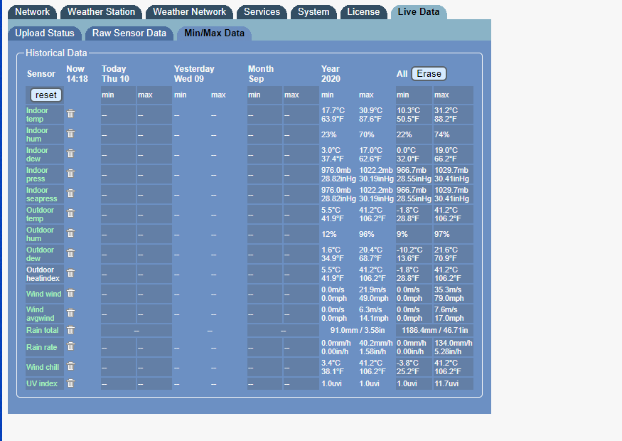

I have checked all the usb ports to hub and usb hub to data logger connected securely. Tried 2, 3 times. Meteobridge "Station" page doesnot shows a red cross in the Vantage USB line.
Still not getting data in live data and also in weatherunderground.
In Min MAx data tab it shows historical data but not current data. Is that still mean usb not connected properly or the stations settings are not correct. I have attached the screenshot.

Hi Admin,
I had checked 1 and 3 properly. But still getting this error. Please help me on this. Thanks
