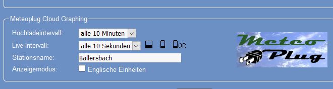

That is strange. I will have to inspect this dependency. No idea why... sending service should timeout, may be timeout is too long and then requests queue up within Meteobridge? Which live upload interval did you use with Meteoplug? 10 secs?

Yes, 10 secs
