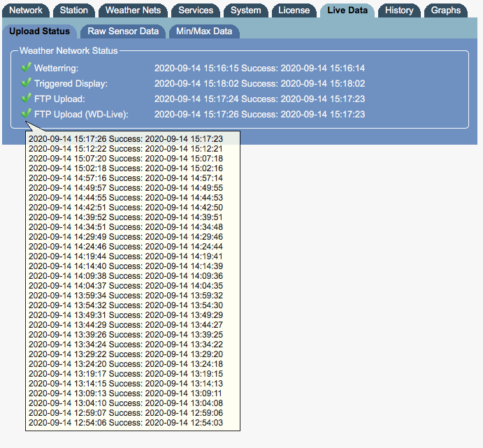

Hi!
I have a problem with ftp upload which doesnt upload anything but logs say success.
Any ideas?
Thank You
Gyvate

Re: FTP Test works, upload status says success but nothing uploaded
@gus: Don't use " or ' in the password. I know because Lukas has asked me to inspect your MB, which I just did.
And please get rid of the unsuited consumer USB stick in the front you are using as primary storage.
The MB PRO has a SLC USB memory inside that can handle the wear. Your stick will fail in the next months.
