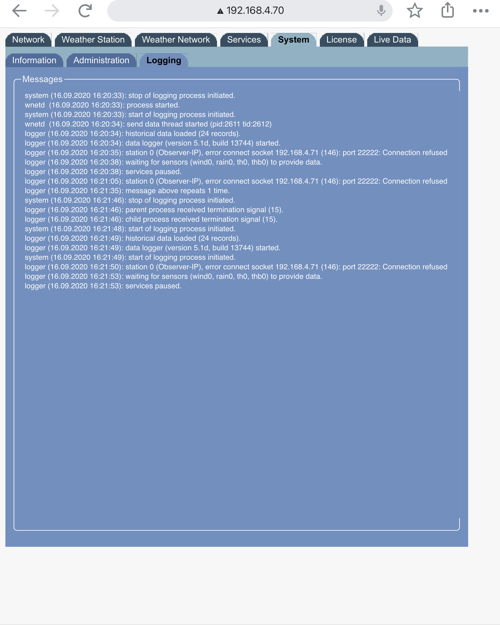

I also have the same problem with ObserverIP. Reload and now I can see the IP setting but the log shows connection refused.
My OberverIP is 192.168.4.71

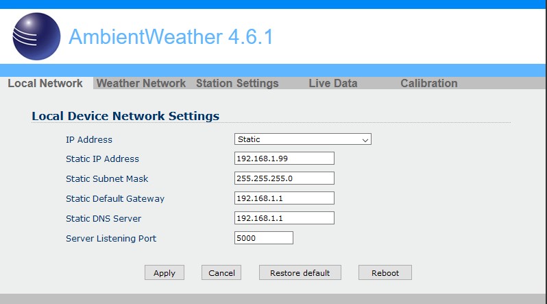

Making progress as far as the setup screen (shows correct IP) but I am getting the same result as Kanok.
logger (16.09.2020 06:48:28): data logger (version 5.1d, build 13744) started.
logger (16.09.2020 06:48:29): station 0 (Observer-IP), error connect socket 192.168.1.99 (146): port 22222: Connection refused
logger (16.09.2020 06:48:32): waiting for sensors (wind0, rain0, th0, thb0) to provide data.
logger (16.09.2020 06:48:32): services paused.
logger (16.09.2020 06:48:59): station 0 (Observer-IP), error connect socket 192.168.1.99 (146): port 22222: Connection refused
logger (16.09.2020 06:49:59): message above repeats 2 times.
logger (16.09.2020 06:50:29): give up waiting for sensors after 120 secs.
logger (16.09.2020 06:50:29): services activated.
logger (16.09.2020 06:50:29): station 0 (Observer-IP), error connect socket 192.168.1.99 (146): port 22222: Connection refused
logger (16.09.2020 06:51:59): message above repeats 3 times.

The problem is that ObserverIP communicating over port 80 not 22222.

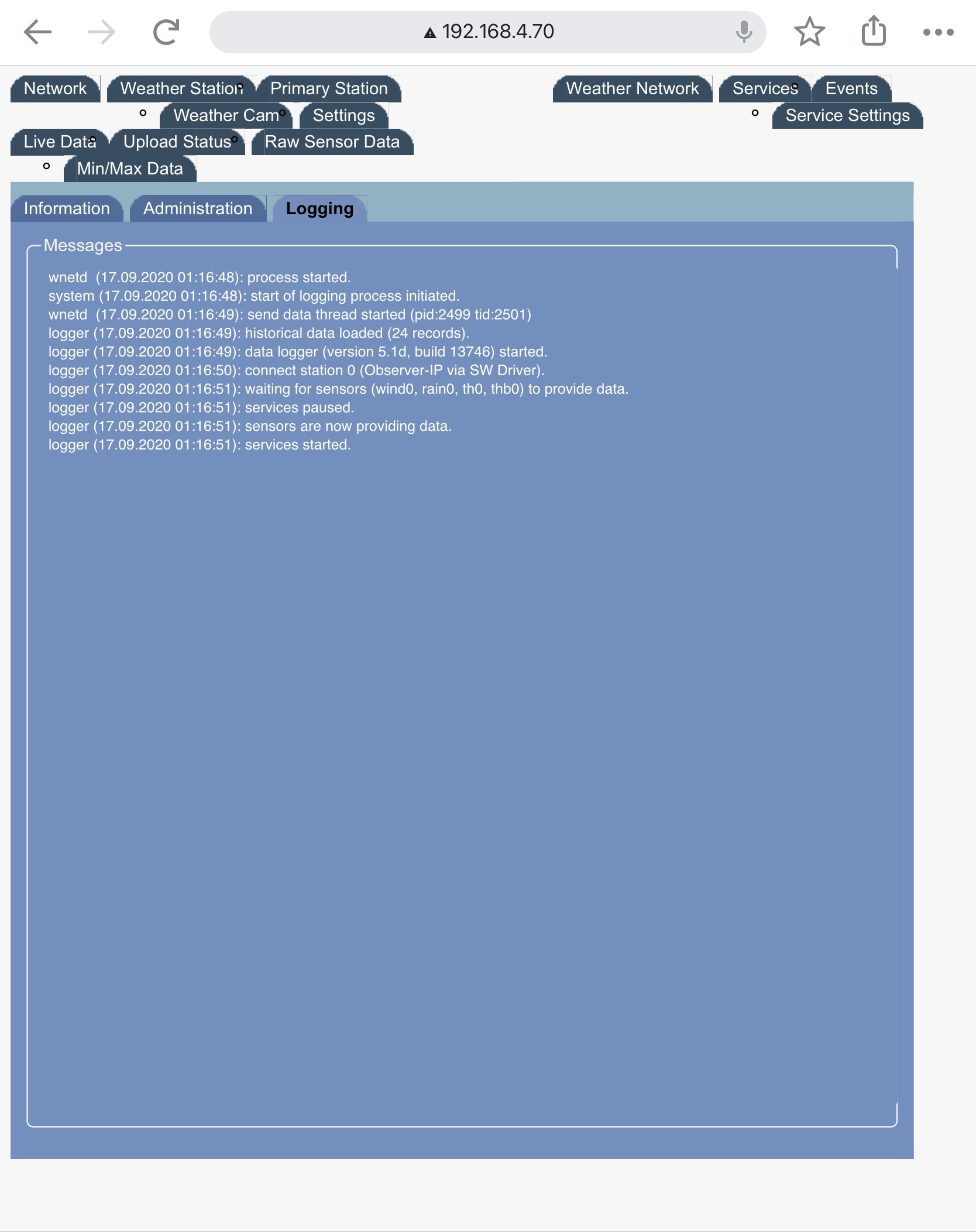

Great! The connectivity issue has been fixed!

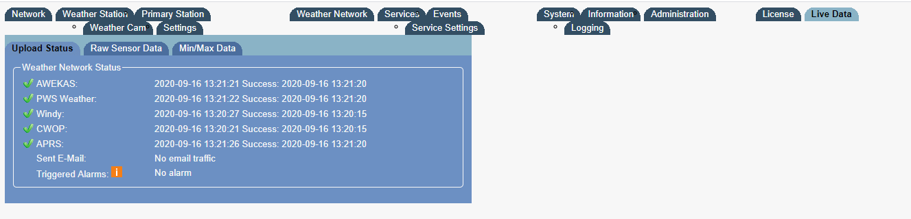

There is minor GUI issue right now.
Re: Meteobridge 4.4 build 13737 - Observer IP.
Confirm the ObserverIP connection issue was fixed but GUI is all over the place.
- 9917A282-F3EA-4BF6-902F-4A7733C61B4E.jpeg (326.83 KiB) Viewed 3880 times
yep, I think it was not so smart to publish the new GUI code without attaching the correspondig css file. Is fixed by now. Please reboot.
