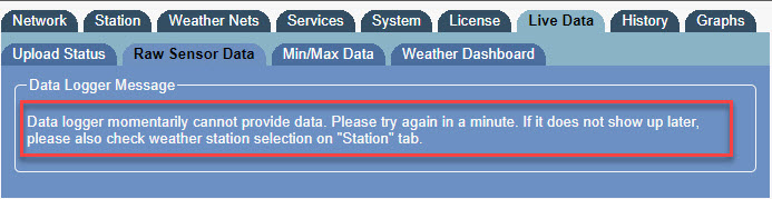

My NanoSD seems to stop sending data once a day over the last few days. You were able to remotely connect and fix something in the past. In the log below you will see I did a backup at 03.10.2020 23:31:06. 10 hours later a "child process terminations signal" which repeats.
I'm running the latest version. If I reboot then it runs fine for a while.

I woke up this morning and NanoSD wasn't sending data and same "termination signal 11". I rebooted as you suggested and everything came back online using build 3461.
I'll let you know how it goes. If it breaks is usually within the next 24 hours.
Thank you.

Posts: 56
Re: Child process termination signal
Post by mthiessen »
It went offline again. Build 3470.
Here is log

mthiessen
Posts: 56
Post by mthiessen »
It continues to go offline once a day. I this happening to anyone else or just me?

logger (14.10.2020 05:39:01): child process received termination signal (11) in functions: termination_handler < inetupload_getlineA8a0 < inetupload_getlineA8a1 < inetupload_getlineA (8) < inetupload_getline < inetupload_getfilteredline < generate_loggerevalfile < generate_loggerfile < gen_CLIENTLOGFILE < gen_INETUPLOADZ < gen_INETUPLOADREQFN < inetuploader < get_sensorid < get_sensorid ...
logger (14.10.2020 05:39:01): disconnect station 0 (Vantage): exit
logger (14.10.2020 05:39:01): disconnect station 9 (System Data): exit
logger (14.10.2020 05:39:02): databases connected. Update interval 3600 seconds.
logger (14.10.2020 05:39:02): data logger (version 5.1d, build 3481) started.

logger (14.10.2020 05:59:08): child process received termination signal (11) in functions: termination_handler < inetupload_getlineA8a0 < inetupload_getlineA8a1 < inetupload_getlineA (8) < inetupload_getline < inetupload_getlineA8b < inetupload_getlineA8a2 < inetupload_getlineA8a0 < inetupload_getlineA8a1 < inetupload_getlineA (8) < inetupload_getline < inetupload_getlineA8b < inetupload...
logger (14.10.2020 05:59:08): disconnect station 0 (Vantage): exit
logger (14.10.2020 05:59:08): disconnect station 9 (System Data): exit
logger (14.10.2020 05:59:10): databases connected. Update interval 3600 seconds.
logger (14.10.2020 05:59:10): data logger (version 5.1d, build 3481) started.

logger (14.10.2020 06:19:15): child process received termination signal (11) in functions: termination_handler < inetupload_getlineA8a0 < inetupload_getlineA8a1 < inetupload_getlineA (8) < inetupload_getline < inetupload_getlineA8b < inetupload_getlineA8a2 < inetupload_getlineA8a0 < inetupload_getlineA8a1 < inetupload_getlineA (8) < inetupload_getline < inetupload_getlineA8b < inetupload...
logger (14.10.2020 06:19:15): disconnect station 0 (Vantage): exit
logger (14.10.2020 06:19:15): disconnect station 9 (System Data): exit
logger (14.10.2020 06:19:16): databases connected. Update interval 3600 seconds.
logger (14.10.2020 06:19:16): data logger (version 5.1d, build 3481) started.

logger (14.10.2020 06:39:22): child process received termination signal (11) in functions: termination_handler < inetupload_getlineA (4) < inetupload_getline < inetupload_getlineA (4) < inetupload_getline < inetupload_getlineA (4) < inetupload_getline < inetupload_getlineA (4) < inetupload_getline < inetupload_getlineA (4) < inetupload_getline < inetupload_getlineA (4) < inetupload_getli...
logger (14.10.2020 06:39:22): disconnect station 0 (Vantage): exit
logger (14.10.2020 06:39:22): disconnect station 9 (System Data): exit
logger (14.10.2020 06:39:23): databases connected. Update interval 3600 seconds.
logger (14.10.2020 06:39:23): data logger (version 5.1d, build 3481) started.

logger (14.10.2020 06:59:29): child process received termination signal (11) in functions: termination_handler < inetupload_getlineA (4) < inetupload_getline < inetupload_getfilteredline < generate_loggerevalfile < generate_loggerfile < gen_CLIENTLOGFILE < gen_INETUPLOADZ < gen_INETUPLOADREQFN < inetuploader < get_sensorid < get_sensorid < get_sensorid < get_sensorid < get_sensorid < get...
logger (14.10.2020 06:59:29): disconnect station 0 (Vantage): exit
logger (14.10.2020 06:59:29): disconnect station 9 (System Data): exit
logger (14.10.2020 06:59:30): databases connected. Update interval 3600 seconds.
logger (14.10.2020 06:59:30): data logger (version 5.1d, build 3481) started.

logger (14.10.2020 07:25:04): child process received timeout signal (14).
logger (14.10.2020 07:25:04): disconnect station 0 (Vantage): exit
logger (14.10.2020 07:25:04): disconnect station 9 (System Data): exit
I've configured a daily reboot at 02:45 AM, but It seems after that error: " child process received timeout signal (14)." MB is not capable to reboot on the next scheduled Time. I did the restart manually this morning 05:13AM
now I have the: (Meteobridge 4.4 (Oct 14 2020, build 3490), FW 1.4) on my MB.

That happens quite a few times, to my station but I thought it was, because I haven't set any "lastgooddata" alarms. I have my alarm-setup now, since about 2 days, and they worked when tested. But it does not help. No Messages arrived on my phone or mail client.
Thanks for any help.
Marco
