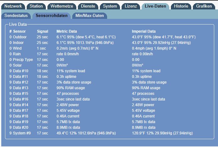

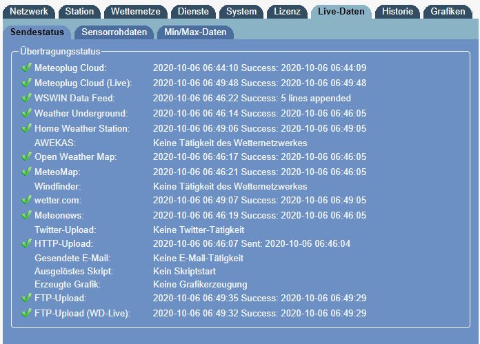

Hello everybody,
since the last update (Oct.5) my data is no longer processed. The pages are uploaded, but they remain blank.
The only thing that works is uploading it to Meteoplug.
Have restarted the system several times.
Meteobridge reads the data from the weather station. (See image)

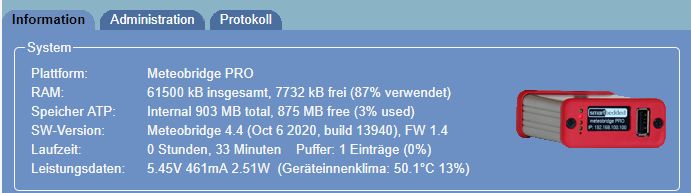

gave an update. Now it works again.

Re: Data is no longer processed
current version should be fine. Please reboot and check.
Links given in the first posts look fine (again). I think this can be regarded solved.
