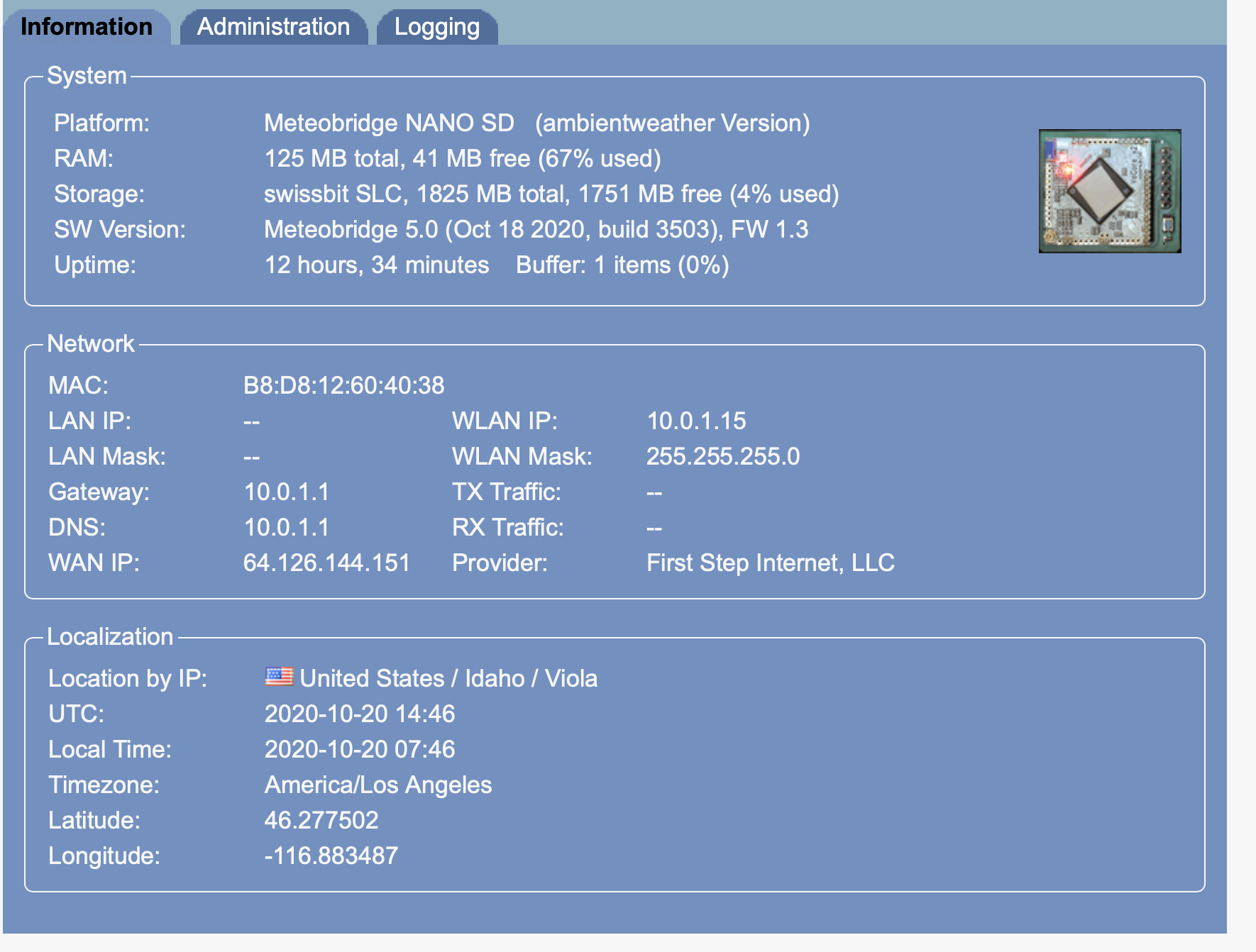

I've attached a screenshot of the System --> Information screen.
MB NanoSD ScreenShot.png (348.89 KiB) Viewed 2225 times

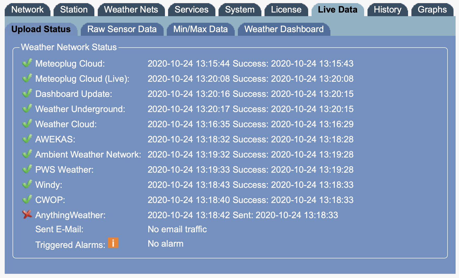

It happened again a few hours ago.
I've attached a screenshot of the Update Status screen. The screenshot shows the last updates around 13:10 and the screenshot was taken at 2020-10-24 15:04. This happens daily. A reboot fixes it. There is nothing in the logs that is different from the normal startup log.

Re: Not updating weather networks
sorry, these screen dumps don't tell me anything.
If you have anythingweather constantly failing and did define retries for it, the buffer will fill up until all this comes to a hold. I made an offer to have a look into your system.
