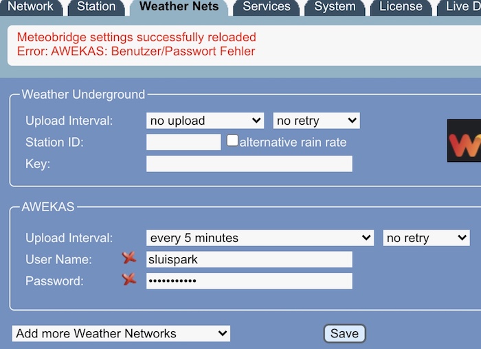

Confirmed:
Can not upload to Awekas using my credentials on a Rapsberry 4B
Also created an extra account => no luck either
See attached screenshot.
RAM: 1903 MB total, 1738 MB free (8% used)
Storage: WD SLC, 14.6 GB total, 14.4 GB free (1% used, 10.0 yrs)
SW Version: Meteobridge 5.0 (Nov 20 2020, build 1511), FW 1.3
Uptime: 23 hours, 8 minutes Buffer: 1 items (0%)See attached screenshot.

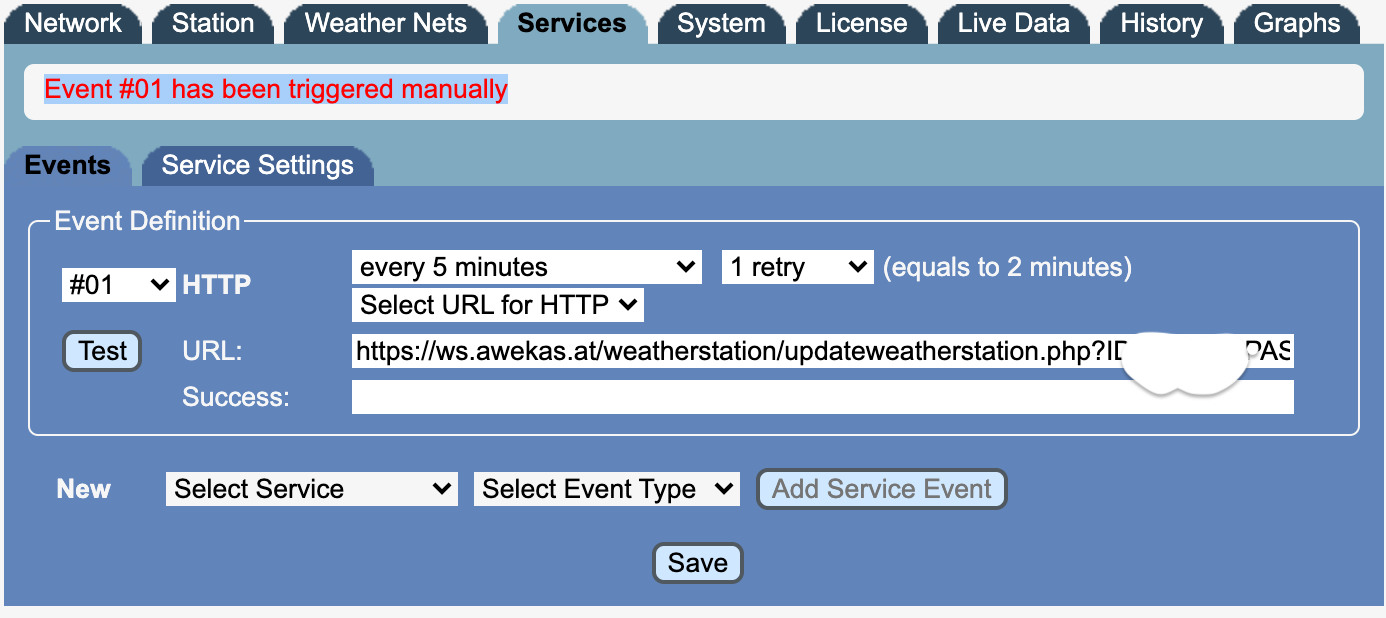

I'm wrong!!!!! But still no dice! I don't get a success. This is what I get:Event #01 has been triggered manually
- Screen Shot 2020-11-23 at 4.26.49 PM.png (121.83 KiB) Viewed 4784 times
Re: My new Raspberry Pi 4 - AWEKAS upload issue
You have to enter in OK into the Success field, then click Save. The purpose of this field is to tell the MB what is the response to expect back from the AWEKAS server if the upload was successful. Every website may have a different Success message to look for. With WU for example the response for Success is SUCCESS in all caps. This is how the MB knows to put in a green check mark or not after an upload.

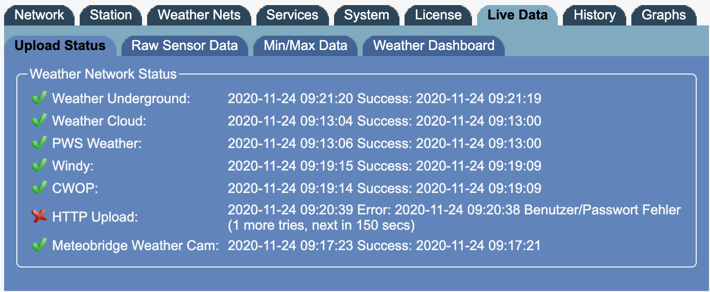

Not working
- Screen Shot 2020-11-24 at 9.21.58 AM.png (183.79 KiB) Viewed 4728 times
- Screen Shot 2020-11-24 at 9.20.50 AM.png (236.49 KiB) Viewed 4728 times

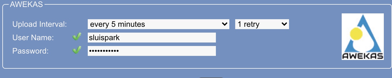

Yes you are. All licenses [that were issued] for the RPI version up until November 24 have to be redone by admin.captgadget wrote: Tue Nov 24, 2020 10:56 pm Not sure if I understand correctly. My license runs through 11-05-2022 so does that mean I'm affected?
Just reboot and go to the licence tab.
Then note down the mac address from the system tab and sent the mail as requested by admin.
I was the first one when testing the fix for Awekas.
Which now works OK.
