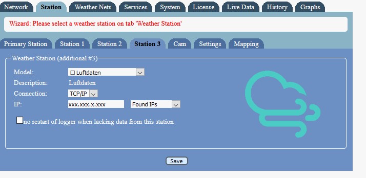

Thanks - I have a file like that but when I add the station to Meteobridge it stops all uploads
Graham

I have a file at http://xxx.xxx.x.xxx/data.json
I have added the above ip as a new station into Meteobridge Pro
Then when I save the station after about 5 minutes the Meteobridge goes offline .This s the message
logger (28.11.2020 12:30:46): connect station 9 (System Data via Plug-in).
logger (28.11.2020 12:30:47): child process received termination signal (11) in functions: termination_handler < forward < chars_avail < process_data < handle_data < set_basic_timeout < forward < chars_avail < process_data < handle_data < set_basic_timeout < forward < chars_avail < process_data < handle_data < set_basic_timeout < forward < chars_avail < process_data < handle_data < set_b...
