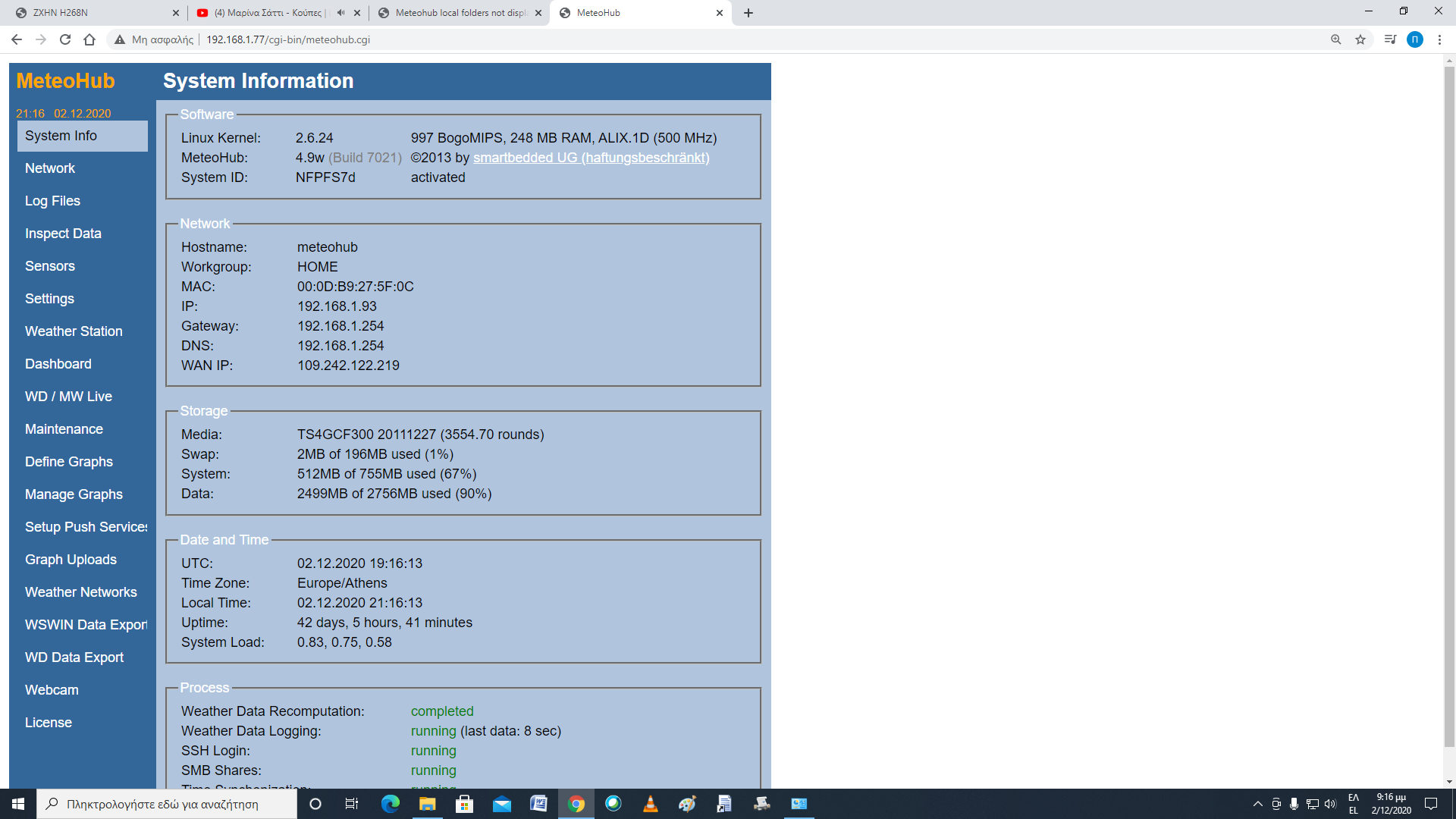

I mention that the old PC still has the normal access to Meteohub local folders at the same time. I attach a Screenshot of Meteohub home page.
Any suggestion what to do to solve this?

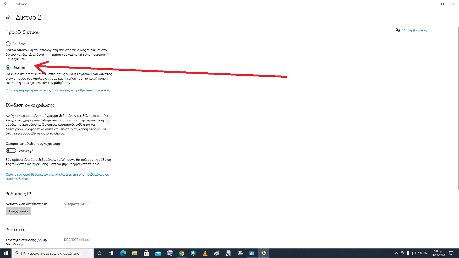

Thanks for your reply, galfert.
Ethernet connection is already set on "Private", as you can see in the attached photo (it's in Greek
But I just mentioned that IPv6 connectivity says "No access to the network". Could this be the problem?

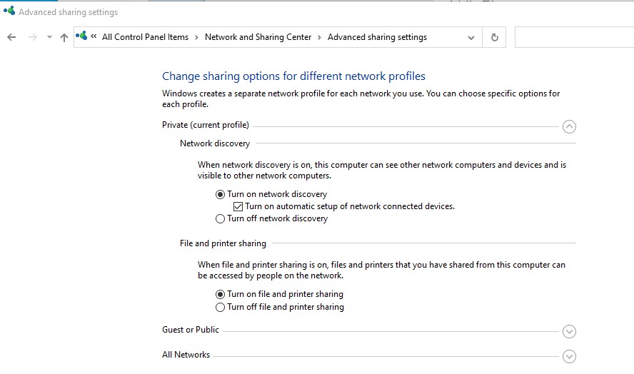

Then also make sure that the following settings are configured for Private networks:

These options are already checked.

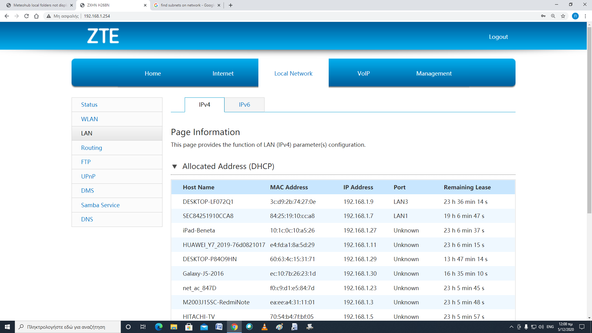

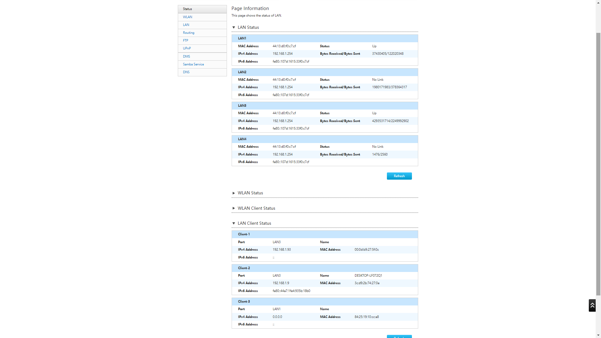

First screenshot is the LAN panel from my router interface. Meteohub is not displayed here, but in the list of LAN clients (second screenshot) with the IP 192.168.1.93. Is it more clear for you now?

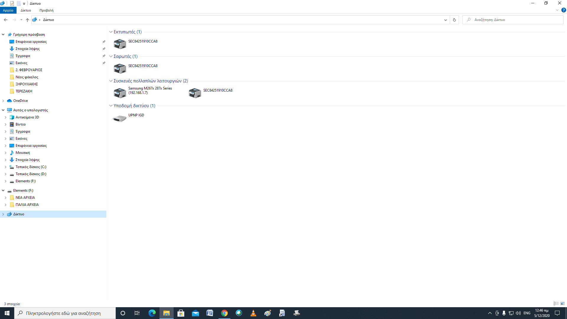

Both Desktops can reach Meteohub interface through web browser (typing 192.168.1.77 or 192.168.1.93), but the new one Desktop is not displaying Meteohub folders on Local Network files, as you can see in the attached screenshot ("Diktyo" is Network in Greek). That's the problem...
