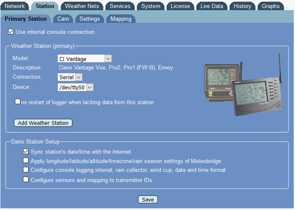

The Davis Vantage Pro 2 system (6152AU) is functioning well with all data being displayed on the console. Nano SD is connected to the Wifi with a fixed IP address.
Have connected and configured my MB Nano SD into the Vantage Pro console per the instructions. Have now done this twice.
Setup in VPro2
Setup in VPro2
JayMacofOz - MB Nano SD in Pro 2 Console - Station - Primary Station.png (143.07 KiB) Viewed 1017 times

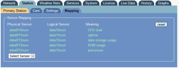

I am currently only able to see the dataNNnum channels.
Sensor mapping
Sensor mapping
JayMacofOz - MB Nano SD in Pro 2 Console - Station - Mapping.png (62.4 KiB) Viewed 1017 times

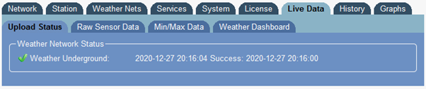

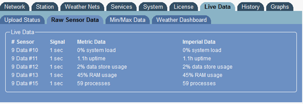

Data is being streamed to WU without issue, but it is limited to this data only.
JayMacofOz - MB Nano SD in Pro 2 Console - Live Data - Upload Status.png (45.35 KiB) Viewed 1017 times
JayMacofOz - MB Nano SD in Pro 2 Console - Live Data - Raw Sensor Data.png (70.2 KiB) Viewed 1017 times

The proper way to connect the NANO is to first power everything down, remove batteries. The data you are seeing are internal functions of the NANO (statistics).

Powered everything down and all working brilliantly! Many thanks.
