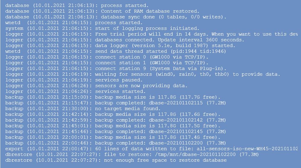

I cannot restore the database on the RPi4
symptoms:
a) the backup files on the USB stick are not visible/selectable
b) if manually provided with backup database, the restore fails saying not enough free space available.

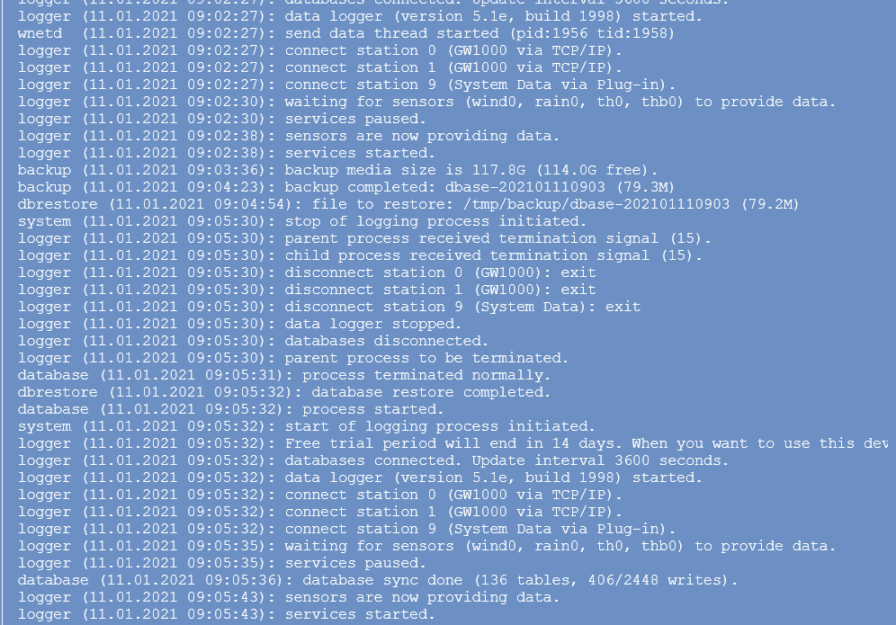

Tested and works - backups on USB stick now visible and selectable.
And the restore goes through without complaints.
Thanks, Boris !

I did attempt to update from my Meteobridge PRO to the Meteobridge PI and unfortunately it doesn't appear that the data updated.

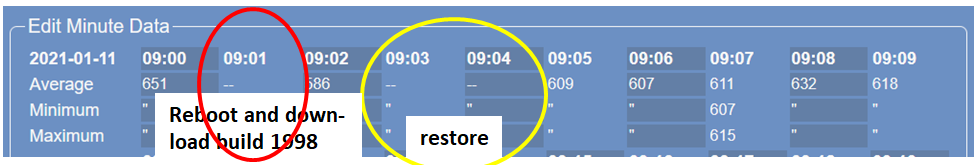

The Meteobridge PRO only has hour data and the Meteobridge PI has both hour data and minute data. The attempt to restore also deleted all of the minute data that the Meteobridge PI had collected. I was able to restore the original database of both hour data and minute data that was backed up from the Meteobridge PI successfully.

same observation here - I did a restore as an initial data load (having set the per minute data option with persistent data for all sensors before the import/restore) and the per minute data from the MB Pro got lost and are only available from the restore date onward.
