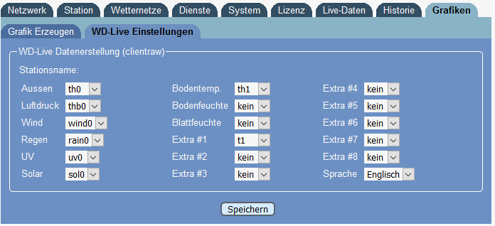

I noticed, that something must have changed after the last FW Update:
I have had the following configuration, which worked fine for me (pls. see screenshots):

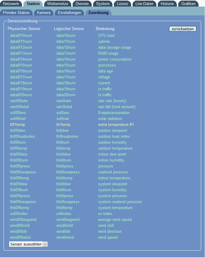

t0!1temp was matched to th1temp:
In WD Live (Clientraw) Extra#1 was matched to t1 and th1 (which is indeed the same data as t1) was matched to Bodentemp:

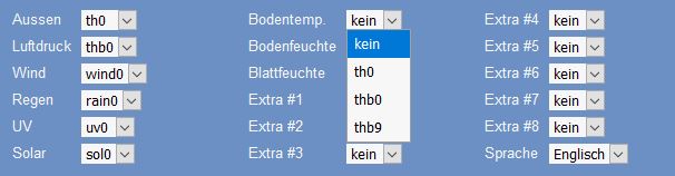

But NOW, after the FW change, "th1" for Bodentemp is missing somehow:
As I am uploading the data to several services (wunderground, windy etc.) and to my SQL Database, to Twitter and sending them via Email, I guess, that THIS might be the reason for the crashes. After deleting all upload services, Meteobridge seems to run more or less stable again.
But the question is now: WHY can't I chose th1 for Bodentemp anymore? This worked perfectly before for month!?

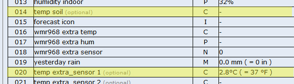

Until to this latest FW Update, it was possible to have a Soil Temperature in the clientraw.txt
Now these figures are missing, I really need data for Soil Temperature!
