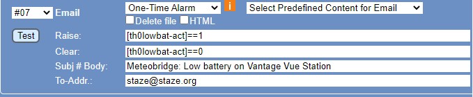

Just realized the battery in my VSS is low, and realized I didn't have an alert configured.
I've got the following set, but it seems like it keeps flipping back and forth between "low" and not.
surprised I'm not getting hundreds of emails....
Thoughts?
Variable flip.jpg (107.26 KiB) Viewed 3046 times

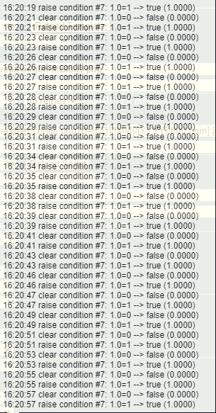

ISS battery status comes from LOOP1 data. LOOP2 doesn't contain battery status. The Meteobridge needs to flip back and forth between reading both LOOP1 and LOOP2 data. Perhaps making a recommendation to Boris that battery status not be updated during LOOP2 is a possible solution.
https://www.wxforum.net/index.php?topic=41225.0
Meteobridge RPI | GW1000
Re: Battery Alert Email
I don't se a flipping in the posting. Raise event is always true (1) and clear event always false (0).

Ah good point. I didn't look that closely.
Non-issue then.

Oooohhhh. Gosh. Now I feel dumb for not looking closely.
Thank you!
Hoping to replace battery on ISS tonight if my roof dries off.
