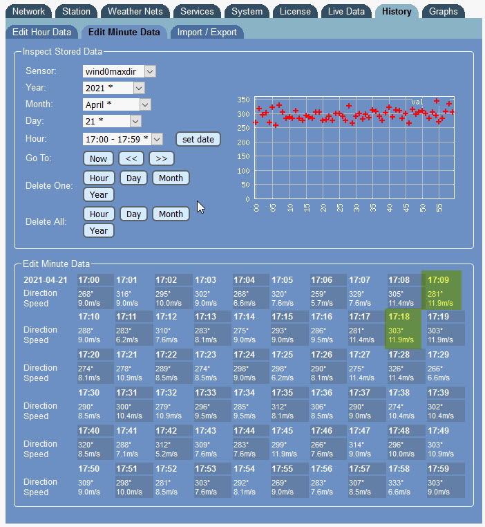

Of course choices has been made, ex: when reporting on sensor and for a given timeframe, having several “max” values (several occurrences of the same max-value) within a given timeframe, it is always the first max-value that is reported (you can see that when also reporting on the max-time for that max sensor value). This is perfectly fine and is consistent thought-out all the sensors with one very annoying exception.
The wind0maxdir-sensor consistently reports the wind0maxdir:degress from the latest occurrence within a given timeframe, not the first.
Reporting on:
[wind0wind-max.1:--] [wind0wind-maxtime.ij:--]:[wind0wind-maxtime.kl:--] [wind0maxdir-max.0:--]
Given that you have 2 [wind0wind-max.1:--]=11,9 m/s first with [wind0maxdir-max.0:--]=281 deg and @ 17:09 hrs and the second one with [wind0maxdir-max.0:--]=303 deg @ 17:18 hrs,
the report would be:
11,9 17:09 303
Where it should be:
11,9 17:09 281
Would it possible change this and make [wind0maxdir-max] consistent with all the other sensors, meaning reporting on the first occurrence within a given timeframe instead of the last.

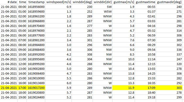

Looks like this issue shows up when doing exports, not when using the template replacement. right?
I checked code and on template evaluation the first occurrence is selected while the export and graphing code selects the last one.
I will change to always first occurrence in next release.

There was a perfect consistency across all sensor on the 23rd release, now the inconsistency has been re-introduced.
There is now no way to get the the wind0maxdir for the either the first or last wind0wind-max, since wind0wind reports first and wind0maxdir reports the last.

just tried april 27th release, the export is still the same as in my april 17th post.
The april 23rd release reported 281 degrees @ 17:09 which was perfect and consistent :-)
