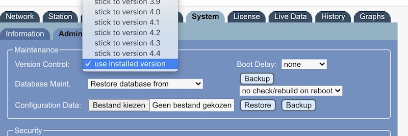

I switched from MBpro to Nano, but the procedure is the same:
Go to tab System => Administration
Click on the drop-down next to Version Control:
Select an older version of the meteobridge firmware
Click on Save and Apply at the bottom, then on reboot.
This will reload a previous version without this problem.

- select.jpeg (79.66 KiB) Viewed 3091 times
