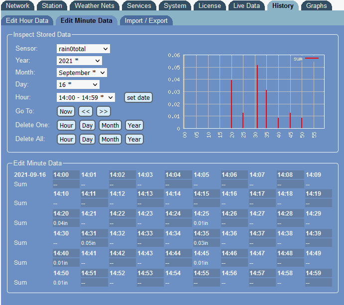

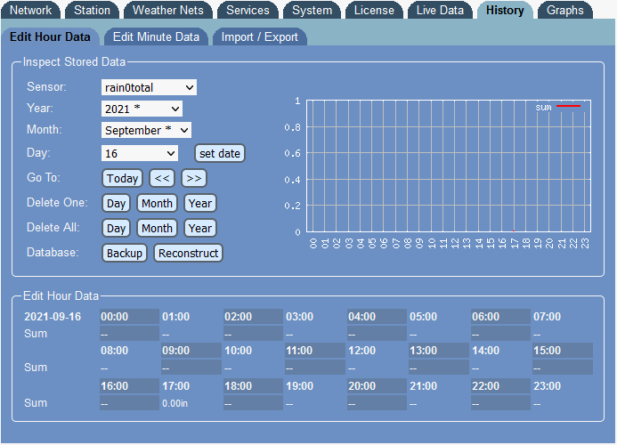

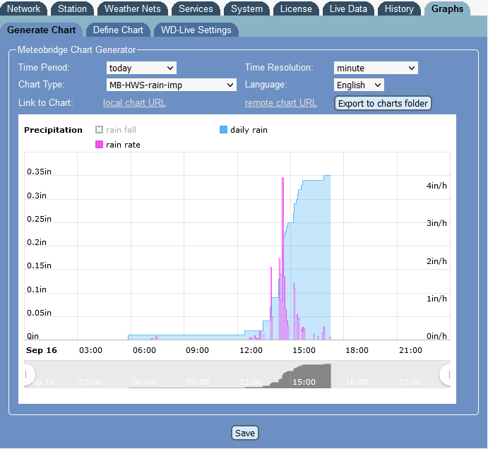

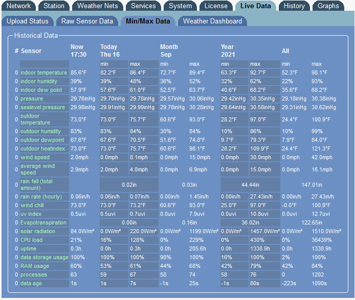

Having an issue today where the NanoSD is not tracking rain correctly. Initially, the "Min/Max Data" tab said 0.00" for today, but the [rain0total-daysum:--] sent to my website was saying 3.2". Figured maybe a reboot would fix that, but now I'm getting different numbers from different places. The value for rain-total-daysum sent to my site is now 0.02", last 24 hours set to my site is 0.00", Min/Max Data has gone up to 0.02", the History "Edit Hour Data" tab says 0.00in", on the "Edit Minute Data" tab for 14:00-14:59 for today it shows a total of 0.16", a generated graph for today's rain shows 0.35". My Davis Vantage Pro2 console currently says 3.23" for the day. Rain has basically stopped for the moment, so no idea if it's gonna track correctly after the reboot.
What's the best way to fix the rain total for the day, since I do know how much it should be total right now?

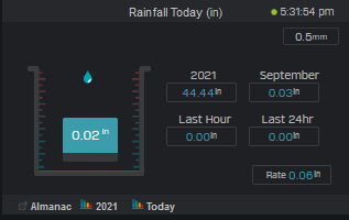

Actually, rain has picked up a little bit since I took those screenshots, today's rain has gone up another 0.01", but the monthly rain and the last 24 hour rain, and the last hour of rain haven't changed.

Well, found the problem. Daily backups of the database filled up the SD card. I have since freed up sufficient space on it and wrote down all the hourly data from the console, just gotta figure out how to correctly add that data to the NanoSD.
Re: NanoSD tracking rain inconsistently
Stored minute data is just for exports and graphing. When you change that it will not effect the hour data and time resolutions above that.
When you want an effect on year/month/day you need to update the hour data.

So just enter the correct data on the "Edit Hour Data" tab and it will automatically update the other stuff then?
lightmaster wrote: Fri Sep 17, 2021 12:19 pm So just enter the correct data on the "Edit Hour Data" tab and it will automatically update the other stuff then?
yes, day/month/year values will be automatically adapted if needed.
