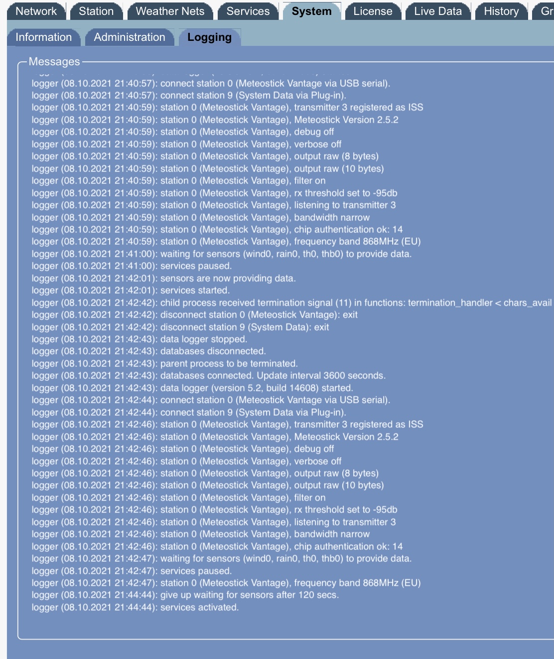

here you can find the log file
- CCD0D752-8548-4C03-855E-CBCAD484CD09.jpeg (472.58 KiB) Viewed 2752 times

Still all good here with FW5.2/14608, been up for around 14 hours, no issues. Your Rx threshold is set to -95db? What signal strength do you see on the Raw Sensor data?

“child process received termilation signal (11)”
this is the error generated in all 3 mb pro with FW 5.2
Maybe the new FW is not compliant with all settings?
Did you find the bug?
Fabio
Fabio
Re: firmware 5.2 of 7 oct issue
Bug should be solved with just released update.
