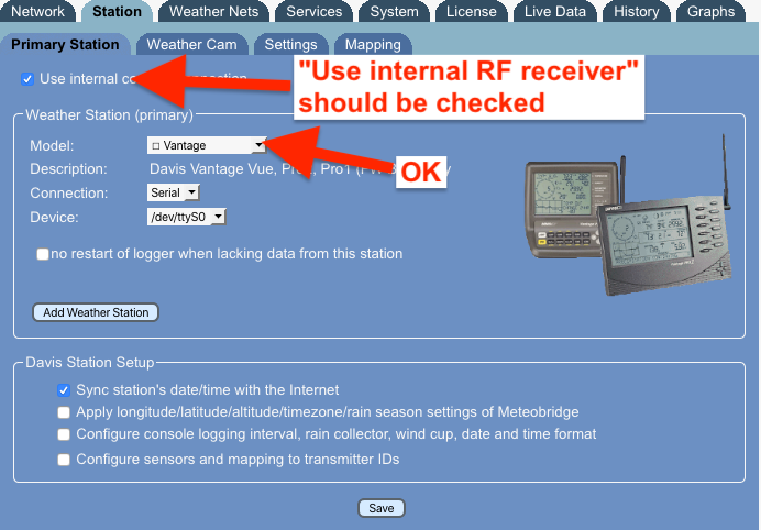

From my memory when i used a PRO and after rereading the meteobridge.com site:
Succes,
If that is not checked an "normal station" connection using USB or WLAN is assumed by the Meteobridge.Meteobridge PRO and NANO offer a "use internal console connection" or "use internal RF receiver" checkbox.
This checkbox should be enabled unless you don't want to make use of these signature features of the NANO or PRO.
Succes,
- Page1.png (133.7 KiB) Viewed 3067 times

Wim, that config look like a Nano setup?wvdkuil wrote: Wed Oct 20, 2021 11:01 am From my memory when i used a PRO and after rereading the meteobridge.com site:If that is not checked an "normal station" connection using USB or WLAN is assumed by the Meteobridge.Meteobridge PRO and NANO offer a "use internal console connection" or "use internal RF receiver" checkbox.
Succes,
Re: Choice of WeatherStation problem in MB
Yes as I have no MB-Pro (now use Rapsberry and small routers) , I copied the first image fromMattk wrote: Wed Oct 20, 2021 11:13 amWim, that config look like a Nano setup?wvdkuil wrote: Wed Oct 20, 2021 11:01 am From my memory when i used a PRO and after rereading the meteobridge.com site:If that is not checked an "normal station" connection using USB or WLAN is assumed by the Meteobridge.Meteobridge PRO and NANO offer a "use internal console connection" or "use internal RF receiver" checkbox.
Succes,
https://www.meteobridge.com/wiki/index. ... ct_Station
The quoted text is just below that image.
Other image attached from the MB website just below "Meteostick and Red Cap Meteobridge PRO"
The image of a PRO should look similar as a PRO-red has an internal meteostick.
- Page1-mbpro.png (76.64 KiB) Viewed 3059 times

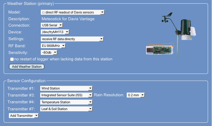

Screen shot of a MBPro connecting via RF directly to a Davis ISS
Now we have a match

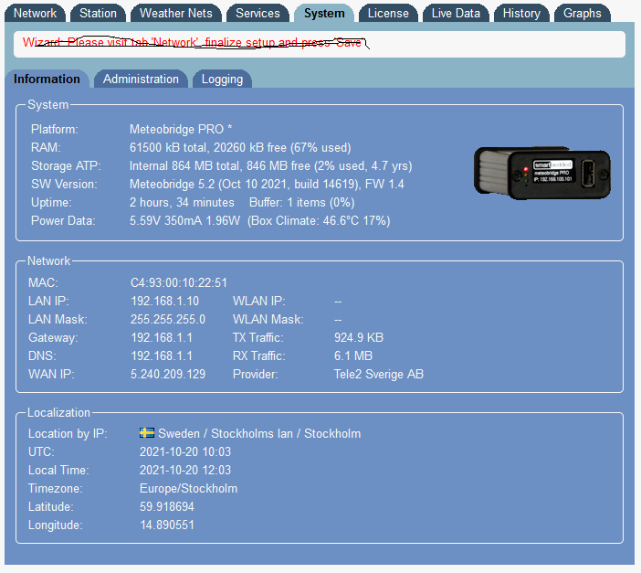

Here the System/Information shows my "RED" as a PRO *

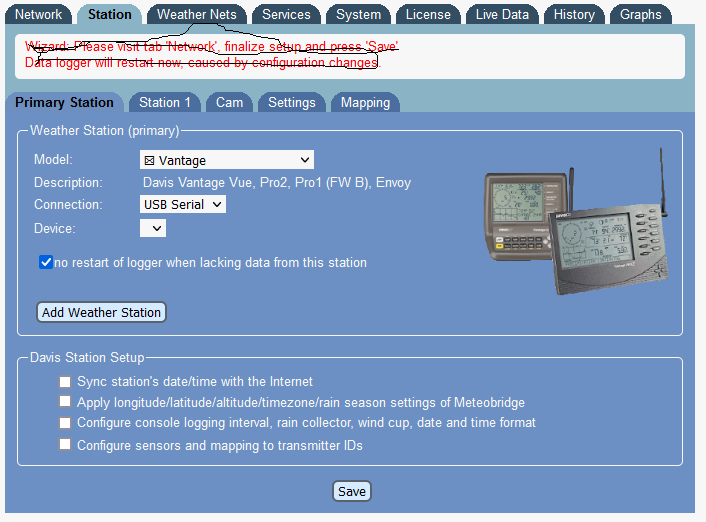

Since "Vantage" only gives options for taking data from Davis console via the usb serial or lan dongle this lacks any device settings

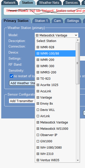

The Meteostic Vantage looks better but only offers "Connection: USB Serial" and no possibility to set any device - the dropdown list is empty...

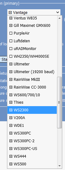

Now here are all possible choises for "Weather Station (primary)". You can see that the lists overlap, so it is complete.
Only Vantage, Meteostick Vantage are applicable - I don't want to go by Davis WLL. No option for direct ! ! ! ! Does using LAN instead of WLAN WiFi on a PRO RED see as a BLACK?
Then you have a malfunctioning device.Bagtjesen wrote: Wed Oct 20, 2021 1:10 pm Thanks for all suggestions,
However the options suggested are not available to me as can be seen by the screenshots below.
Is the colour of the casing red?
Are there TWO antenna's?
Both RED colour and 2 antenna's are needed for a PRO-RED.

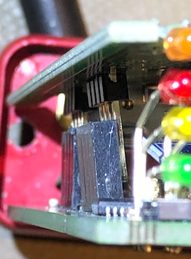

Inspection of the unit showed that is was an assembly problem. The connector of the RF board did miss the contacts on the base board. This can easily happen, when disassembling and then reassembling the MB PRO. I would like to rule out that we shipped it that way, as it would not have passed the function test we do. However, this is not about finding out who did what, but to give you a hint what to look out for when doing a disassembly/assembly yourself. Unit is now on its way back.
