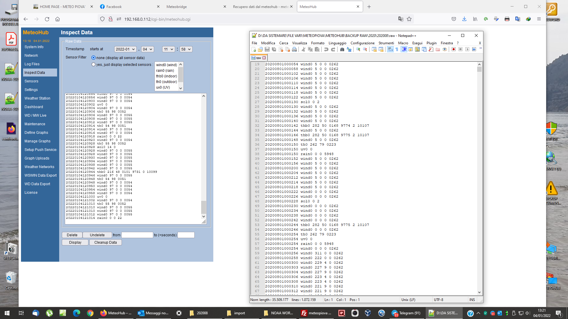

Senza titolo.png (424.29 KiB) Viewed 5486 times
The raw raw data of the weather hub have only the data relating to the sensors, the calculated values such as heatindex and windchill are not there, as per the attached image, but once the data has been imported, the values relating to the windchill are found and heatindex are not ... ..

Windchill data is in the wind lines (last item). Meteobridge does not compute it. As heatindex is not in the data it does not show up on import. Works as designed, no bug.
Just checked how to compute heatindex. As it does not depend on data apart from the TH sensor, Meteobridge could do a rather easy computation on imnport. I will put it on my todo list.
