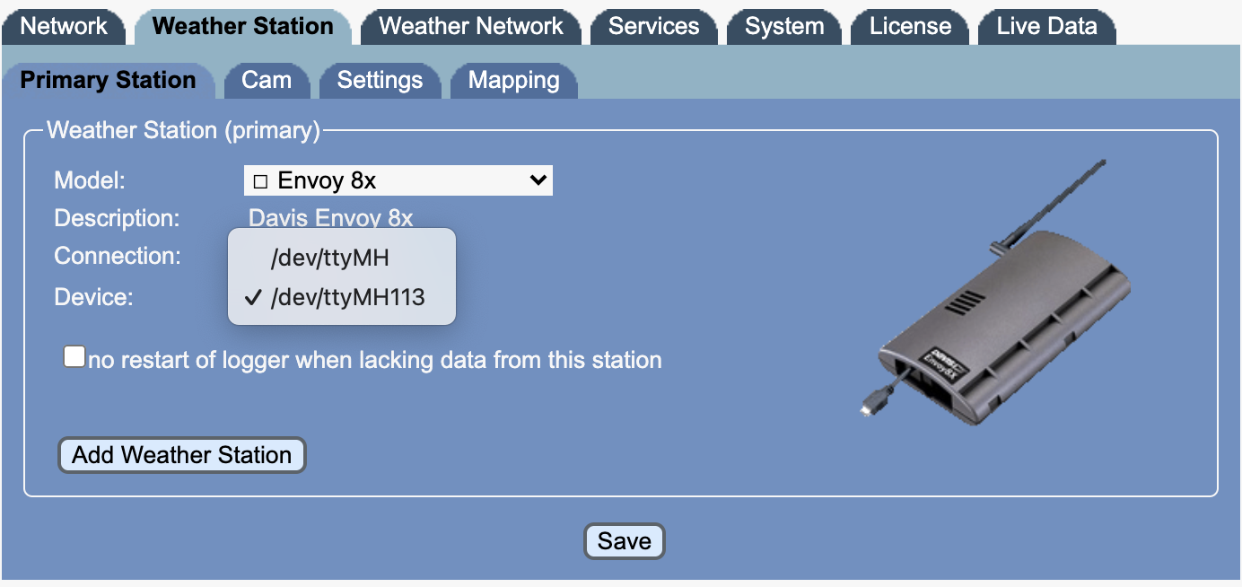

I have added the envoy 8x in and selected one of the "Device" options. Not sure what the difference is between the two:
Screen Shot 2022-01-10 at 4.01.22 pm.png (232.86 KiB) Viewed 1306 times

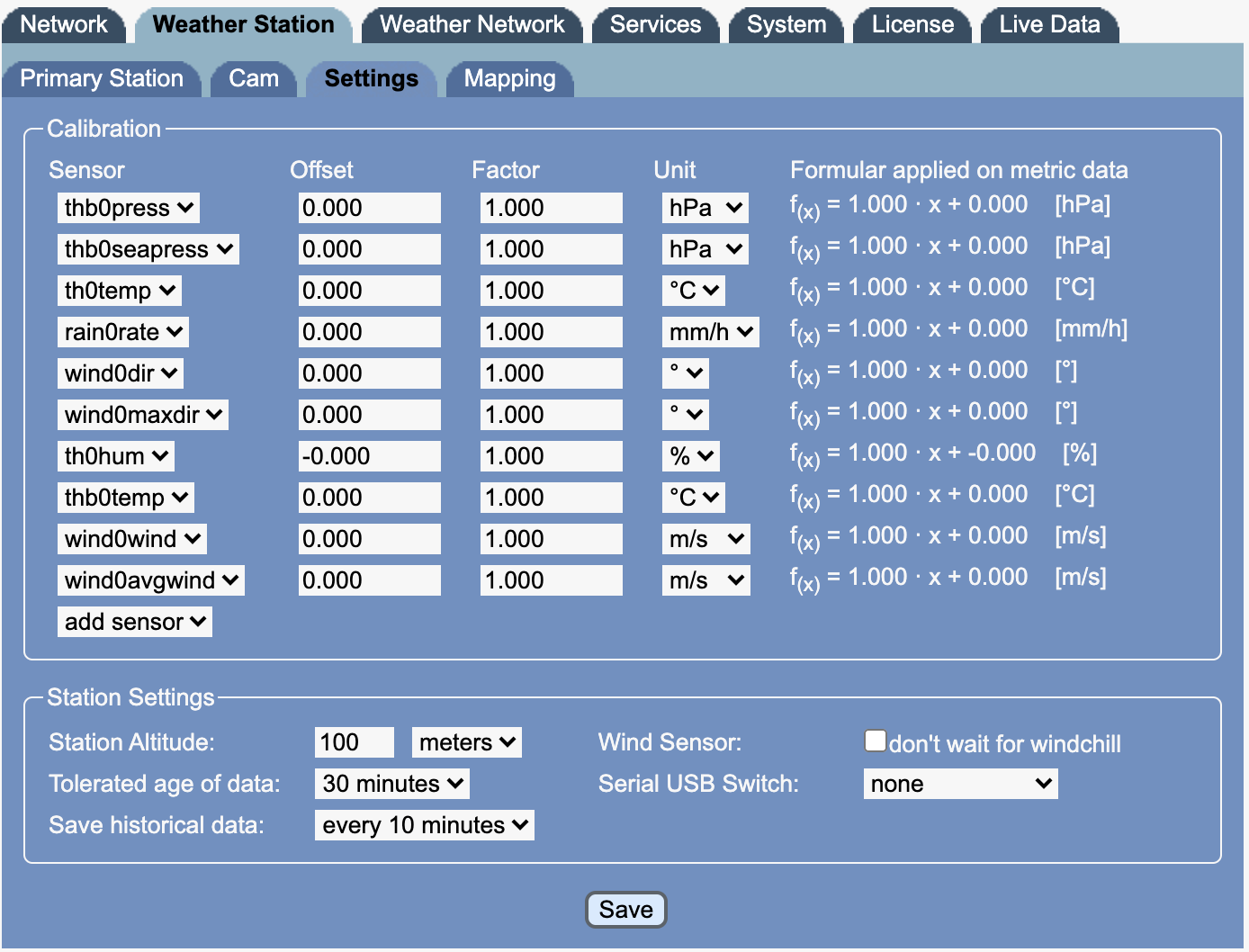

I have these settings in place:
Screen Shot 2022-01-10 at 4.09.45 pm.png (253.27 KiB) Viewed 1306 times

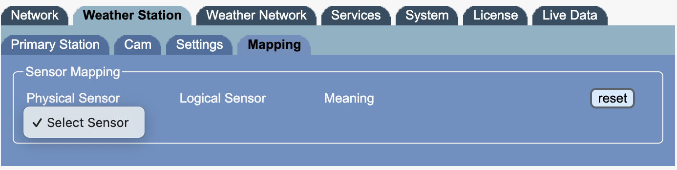

When I look at the Mapping section I don't have any options:

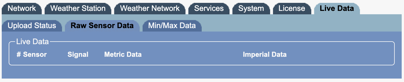

So with these settings, I don't see any live data coming from the Envoy 8x or the vantage transmitter:
Screen Shot 2022-01-10 at 4.12.08 pm.png (67.33 KiB) Viewed 1306 times

Are you sure you have one of the very few "Envoy 8x"? I think you have a regular Envoy and then you have to select "Vantage" as station type.
BrentonSpear
Posts: 8
Joined: Mon Mar 06, 2017 6:04 am
Re: Envoy 8x not returning data
Post by BrentonSpear »
I changed it to Vantage and it seems to be working now.
