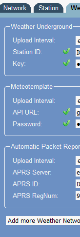

is there any possibility to run the Meteobridge Pro with multiple, but **same** networks?
I am using Meteotemplate as GUI in internet and now consider to set up a second meteotemplate in internal LAN for testing.
But it seems, that in MB I cant add the Meteotemplate as a weather network a second time?
I expected a second section with Meteotemplate, but no new section appears.

as far as I know there is only one post per weather network / template in the Weather Nets section (tab)
however, you can create your own http request to your 2nd Meteotemplate installation (Sevices/Events) - just need the proper APi string to be sent.
For an example have a look at viewtopic.php?p=40347#p40347
Even though the text is the German, the API string example is there.

it works - I'm posting to two different Meteotemplate installations with my customized API string - as the default MB post doesn't contain all my sensors.
Example: see my signature link and look for Meteotemplate on the landing page
