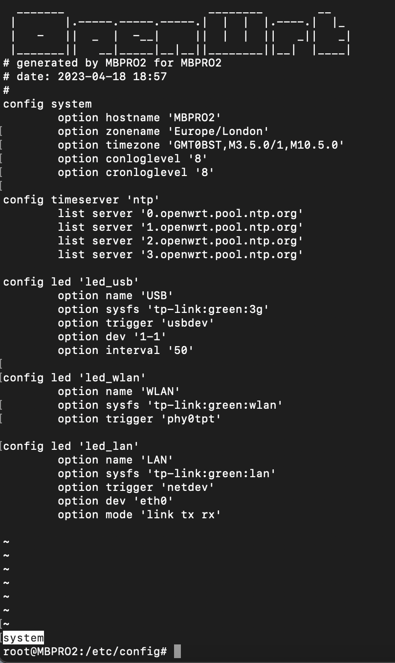

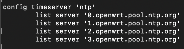

Have managed to find the system config file on my MB Pro 2 and the following NTP servers are configured
Hope it helps
Mark.

MGS
Posts: 25
Joined: Sun Mar 12, 2023 10:17 am
Re: What NTP Time Servers URLs does the Nano-SD use for Time Synchronization
Post by MGS »
Hi Ron,
If you SSH to the Nano SD and go to the /etc/config directory there is a file called system and in this file I found the NTP server setting on my PRO2 as below
Hope its helps you
Mark.

rzelle-K1TTC
Posts: 243
Post by rzelle-K1TTC »
Mark,
Thanks that's where it is on the Nano so I verified it was using the same urls. I had configured my DNS servers with those urls to point to my local ntp satellite receiver and it also picked up the Purple Air as a NTP client. A win win ..
.. Ron
