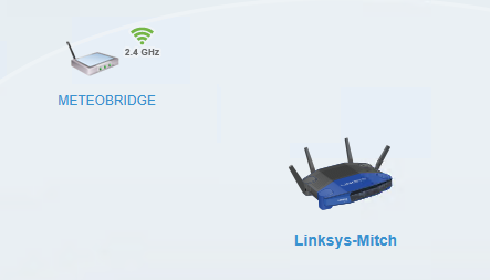

The Nano SD is about 5 feet from the router. I checked the router and it shows full scale signal. After the last reboot i disabled weather underground, CWOP and WD live uploads to see if one of those is the issue. The Nano has been running since yesterday at about 5:50pm.

I have CWOP, weather underground, WDL and graph uploads on. So far so good. I left my web page upload off. I am going to let it run a week and if no issues turn it on. Its a modified WL template from 20 years ago. Maybe that's the problem? www.mlmweather.com/MB.html
I have a 1amp 5volt dc power supply and batteries tested at 1.58VDC. The VP2 came with the 1amp USB power supply. I did buy a 3amp 5VDC. Would that be enough? Haven't wired the plug for it yet. Will wire it up this coming weekend.
