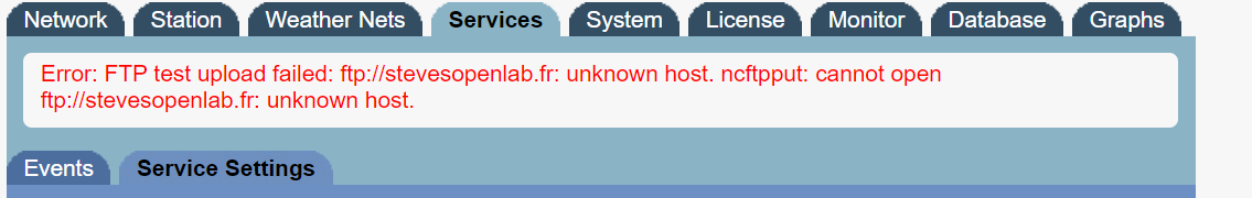

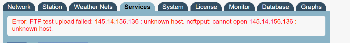

I am getting the Unknown Host error message when I try to transfer files from a Meteobridge Nano SD to my host provider.
I have been chatting with my provider for the last 45 min and they are unable to resolve the issue.
The only thing they could recommend was for me to use Filezilla instead, which they assure me works well. But I'm guessing this is not an option here (but correct me if there is a solution).
Is there a workaround here?
meteobridge ftp error2.png (28.42 KiB) Viewed 6362 times
meteobridge ftp error.png (39.39 KiB) Viewed 6362 times

Where from and how are you sending FTP? Does the FTP/SFTP Service Settings test ok, or is this the test result?

From the Meteobridge NANO console, I go to /Services/Service Settings sub menu. I fill in the required fields in the FTP/SFTP section. Then click the Test FTP button. After a few seconds, the error message appears.

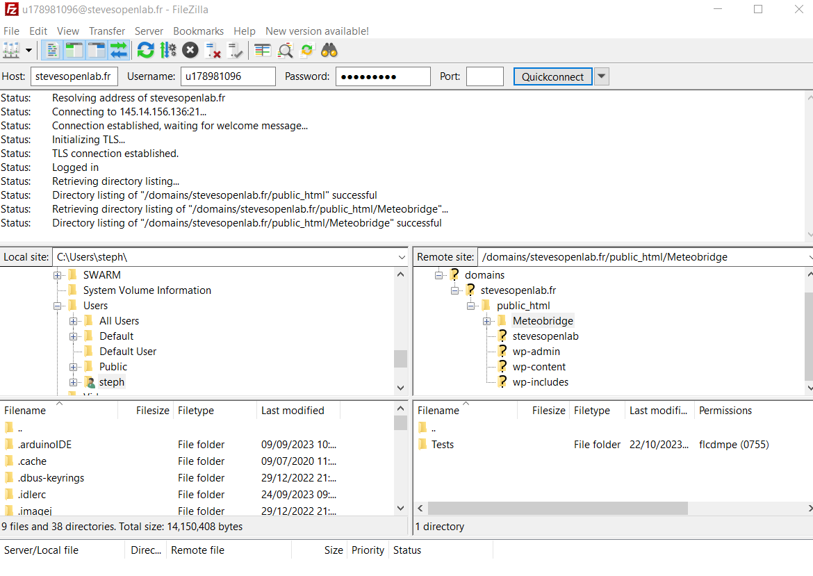

Filezilla works fine outside of Meteobridge. No connection issues. It's only when I try to transfer files within Meteobridge that the error occurs.
Re: Unknown Host Issue with standard FTP
Are you sure that the server offers plain FTP?
Filezilla adapts automatically to FTPS or alike. The logs should tell you.

Connection within Filezilla works fine. It is only with FTP within Meteobridge thatr the issue arises
stevejd64 wrote: Sun Oct 22, 2023 5:36 pm Connection within Filezilla works fine. It is only with FTP within Meteobridge thatr the issue arises
The log shows TLS is used for your Filzilla communication.
That is not plain FTP but secured FTP either SFTP or FTPS a.s.o.
Modern FTP clients switch automatically to a more secure protocol, if available or requested by the FTP server.
Please connect via SFTP or Proxy-SFTP options of Meteobridge to adapt to the enforced encryption by your server.

However, I am still seeing the following errors.

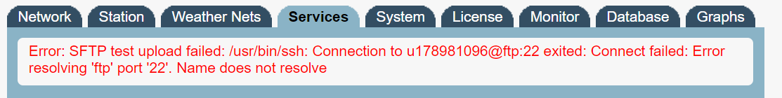

Using port 21 and testing with SFTP:
meteobridge ftp error3.png (33.27 KiB) Viewed 6321 times

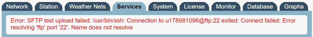

Using port 22 and testing with SFTP:
meteobridge ftp error4.png (33.5 KiB) Viewed 6321 times

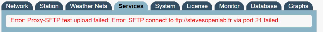

Using Proxy SFTP on Port 21:
meteobridge ftp error5.png (25.68 KiB) Viewed 6321 times

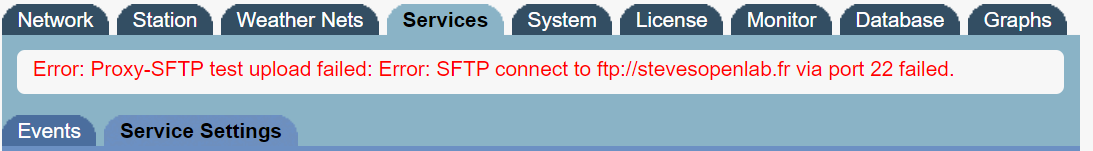

And using Proxy SFTP on Port 22:
meteobridge ftp error6.png (36.27 KiB) Viewed 6321 times

Looks like you are poking around. If you send credentials to info(at)meteobridge.com I can help to find out. Please set password to a temporary one, so that I just have short term access.
Or please post the complete screen. Having ftp in the URL/hostname might not help when trying to connect via SFTP.
