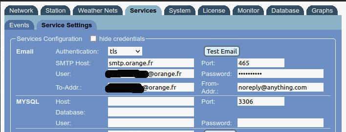

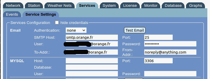

some printscreens as adviced
- meteobridge-mail-bug_1 .jpg (52.57 KiB) Viewed 2847 times
- meteobridge-mail-bug_2 .jpg (59.9 KiB) Viewed 2847 times

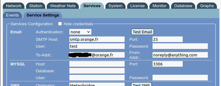

Re: New MB , SMTP mail issue
other printscreens , neither results ... damn ..
- meteobridge-mail-bug_4 .jpg (51.09 KiB) Viewed 2847 times
- meteobridge-mail-bug_3.jpg (50.73 KiB) Viewed 2847 times

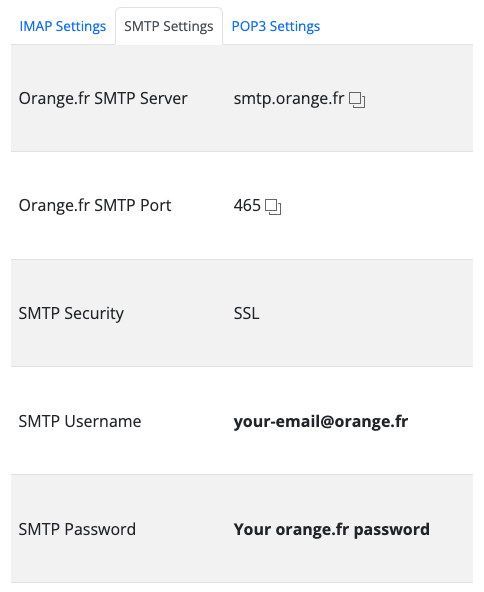

Orange tells this:
Some providers enforce that From-Address is from the same domain, here "orange.fr" to avoid spamming.

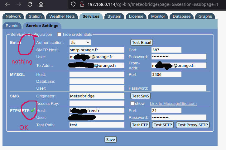

, i try a foolish parameter : set port to 587 ( idea found in viewtopic.php?t=17576 )
and it works !
BUT
- neither message ( succeed or failed ) from the MB after clicking "test email"
- nor green mark
what the hell is this mystery !
screenprint for info
What you quote above is exactly what i try first (see my 1st post) and exactly the parameters i use in my Thunderbird mailer ...
I try again , as usual , i get the message "Meteobridge settings successfully reloaded " when clicking "save"
but nothing new ... , damn !!
Just before hanging myself
and it works !
BUT
- nor green mark
- mteobridge-mail-bug_partially solved .jpg (84.47 KiB) Viewed 2818 times
