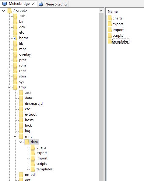

I have got a strange issue:
After a reboot, the "data" folder with all subfolders "charts", "export", "import", "scripts" and "templates" are missing.
So I need to create all of these folders manually after each reboot.

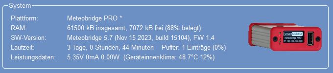

Never heard of or seen that. Which Meteobridge version are you using?
Can you please share data from "System - Information" tab?

As the USB storage is not listed on your "System - Info" tab something with your storage is wrong. Please share output of "http://ip-of-your-meteobridge/cgi-bin/system.cgi?dmesg" to get an idea if the storage itself failed or the internal USB hub is causing problems.

Re: Meteobridge Pro - Missing folders after reboot
Your storage ist defective. Are you operating with the internal USB stick of the MB PRO?
What does "lsusb -v" report?
WETRHE
Posts: 47
Post by WETRHE »
Yes, it is an internal USB Stick abd it has already been exchanged as the other one was defective.
But same issue with the other USB stick before.
