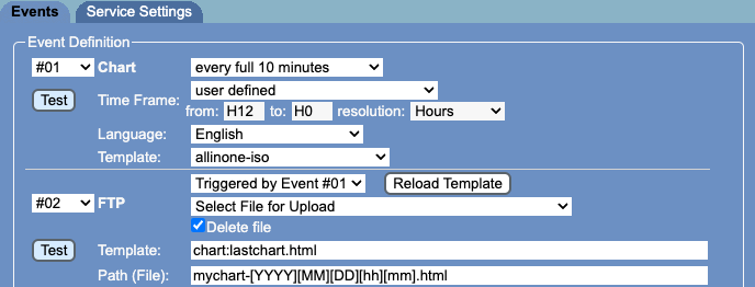

You define an event to generate the chart (let's say every 5 mins) and trigger an SFTP/FTP upload event on "lastchart.hmtl" for this. Then you iframe this uploaded chart into your own servers web presence. Every 5 mins it will be updated by a more recent one.

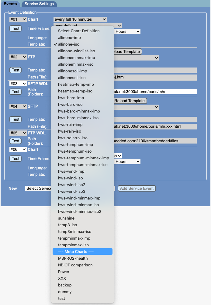

I have created several meta-charts and I want to upload them via ftp to my server using event.
IE
I add an event with ftp. When I press "select file for upload" the mete-charts do not appear!

The way to do this is to generate a chart by a certain periodic interval and to trigger the FTP upload event from there by using the just generated chart "lastchart". Please don't forget to set the "delete" mark, otherwise your Meteobridge's internal storage will fill up with all the generated charts. You can use a constant ftp target name or one that includes timestamp info (as in the example).

Does this method work on any chart - including the ones that are user defined?
I can create and upload allinone-imp but the user defined ones do not seem to work.
Guy

yes, of course. What exactly is the problem?
On my PRO2 is see these options:
Bildschirmfoto 2024-02-26 um 13.23.28.png (234.58 KiB) Viewed 3087 times

If I select another chart (user-defined) - it does not seem to be created and uploaded as an html file. Using the same settings as you show (except the chart definition name of course). allinone-iso has no problems.

grwkak
Posts: 220
Re: Long delays in the display of meta charts!
Post by grwkak »
Just sent from my Gmail account. Its the last chart listed (event 5).
