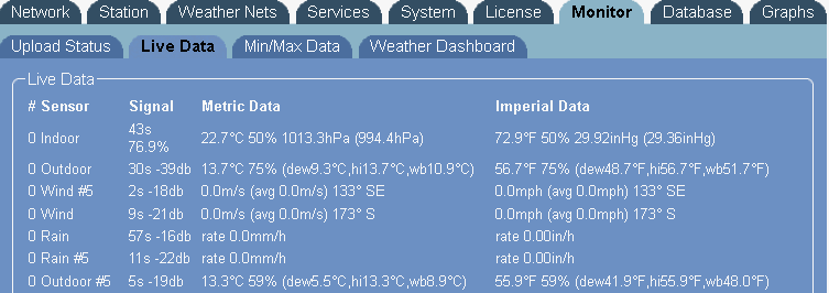

I set Pro2 station with ID 2 and Vue with ID 5 with "receive RF data via console(retransmit)"
In the live data menu, however, there is no data from sensor Indoor #5
Why?
Why?

Re: Problem with two Davis stations
Indoor data is not part of the RF communication. Indoor data is generated by the consoles and not shared via RF.
Meteobridge does have one indoor sensor (also providing pressure).

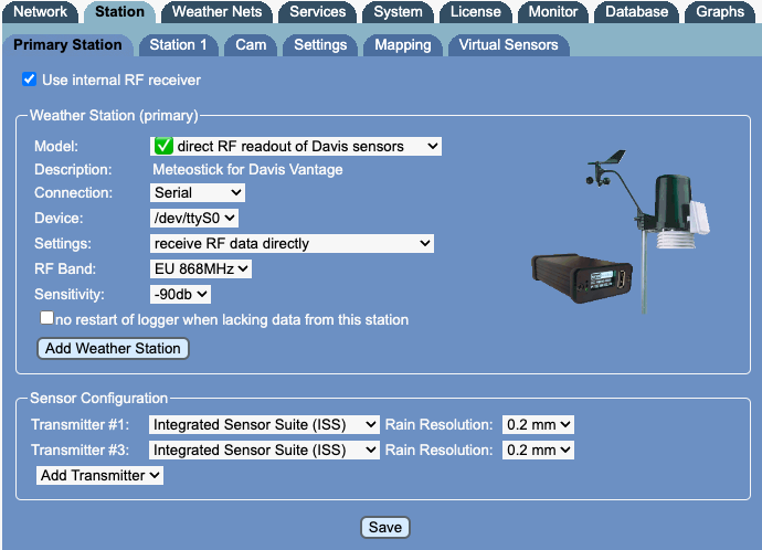

I'm coming back to the same topic.
I have set
Pro2 with ID 1 and receive RF data via console(retransmit) with ID 2
Vue with ID 4 and receive RF data via console(retransmit) with ID 5
With receive RF data directly and sensitivity from -70 to -95db
If I define Transimeter 1(Pro2) and Transimeter 4(Vue) showing data from Vue only!
In order to display data from both stations, I must set Retransmit and Transimetter 2(Pro2) and Transimetter 5(Vue)

I have two stations connected to meteobridge
1. Davis Pro2
2. Davis Vue
If I select "receive RF data directly"
meteobridge only receives data from Vue and not from Pro2!
If I select "receive RF data via console(retransmit)"
meteobridge receives data from both stations!
There will be no data from any "indoor" sensor using retransmit (as such), as re-transmit simply re-transmits the raw ISS data from the ISS. nothing from any indoor sensors, indoor sensor data would come from a console or (MB) receiving the re-transmit.zakos52 wrote: Tue Mar 19, 2024 12:17 pm In the live data menu, however, there is no data from sensor Indoor #5
Why?
In the Live data screen shot [0 Wind] & [0 Wind #5] are both receiving data based on the Signal
Similar with [0 Rain] & [0 Rain #5]
[0 Outdoor] & [0 Outdoor #5] both have data
So what was your question again?

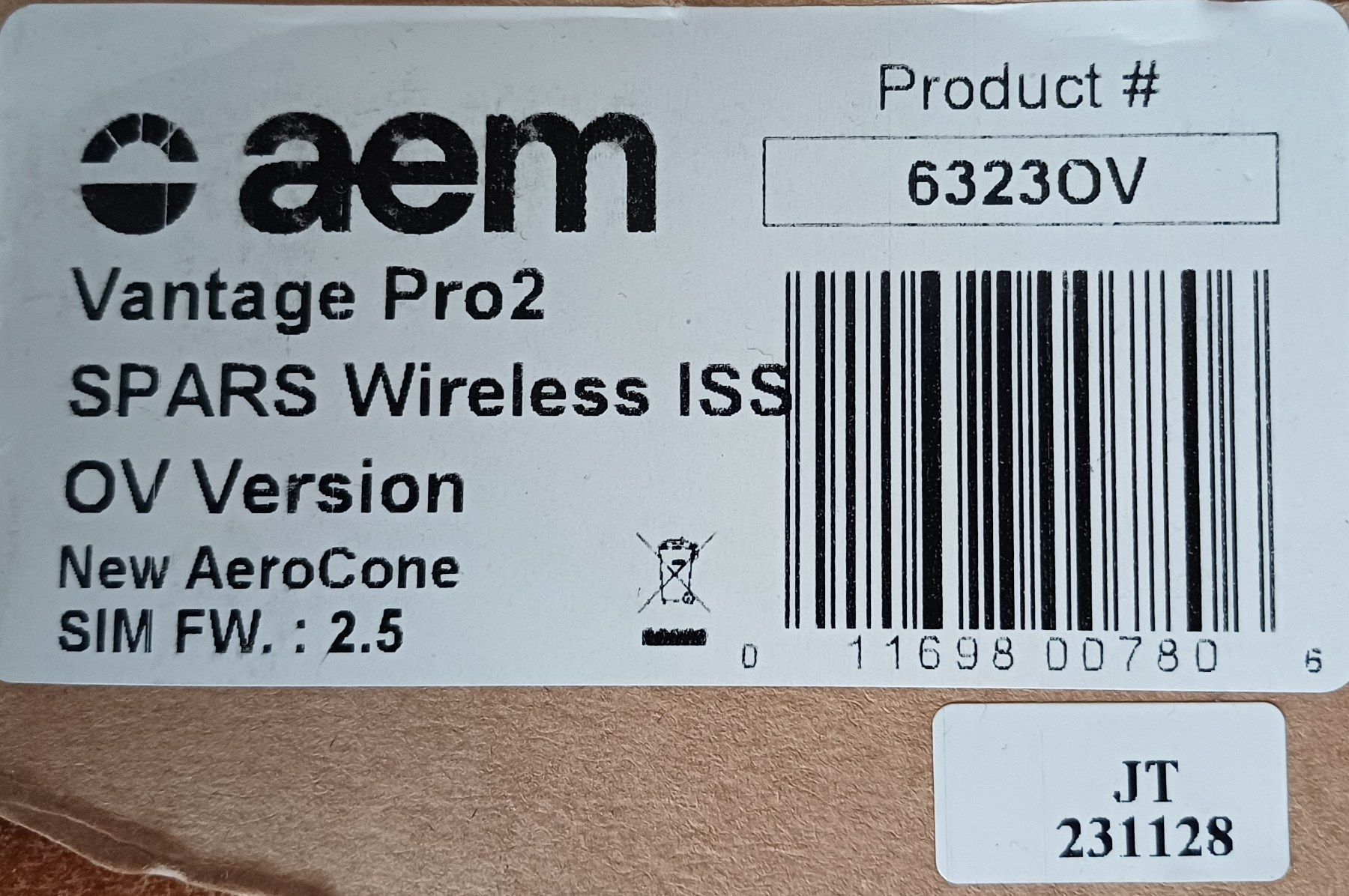

My Vantage Pro 2 ISS (Davis 6323) does not include a console and was manufactured in November 2023.
The label (image) contains the information for this model.
There may be changes in the communication protocols for this station, that's why the meteostick can't receive live data, but only through the relay console (retransmit)?
