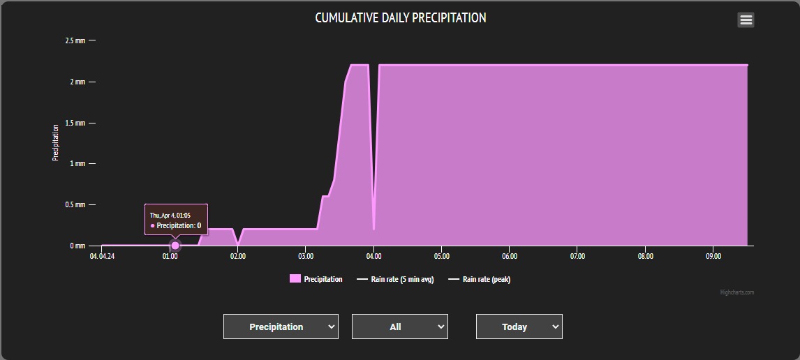

The problem is still present with Ver 5.8, see last nights rainfall
Screen Capture 007.jpg (40.56 KiB) Viewed 1358 times
Notice that 2.00am shows actual value from 1.00am (0mm), 3.00am shows value from 2.00am (0.2mm - happens to be correct), 4.00am shows value from 3.00am (0.2mm) the rest of the night looks ok because there is no more cumulative rainfall.
