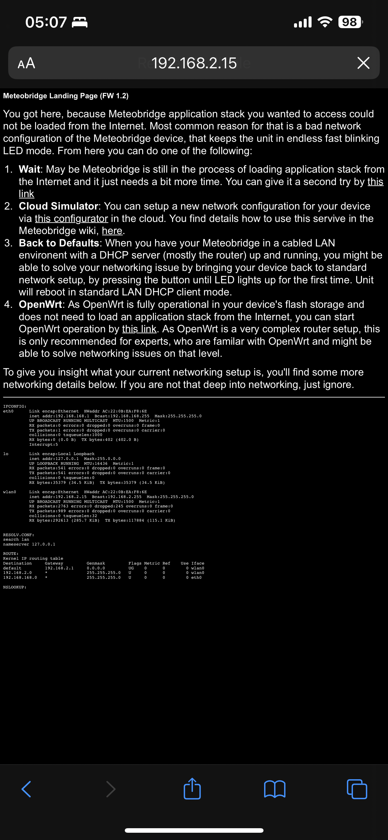

Since 2 o'clock in the morning I see that my weather data has not been sent to other meteorological websites. After entering meteobridge, I saw a message!
What could it be? Is it a general problem or is there something wrong with me, even though it is not that I have touched anything on my part!

The problem is that to access meteobridge for configuration, only this part that I sent as a screenshot is displayed.
What can I do now, please?

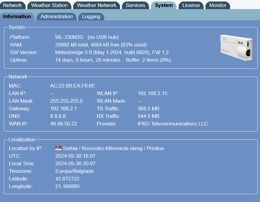

admin wrote: Tue May 21, 2024 9:46 am Which Meteobridge SW version are you using? Looks like outdated SW.
Is this what you are looking for? Still Windy isn't working.

Re: Meteobridge is not working since 02:00 AM (GMT+2)
Another router platform EOL for many years... Can you please use newest Meteobridge SW to rule out that you are struggling with issues already solved.

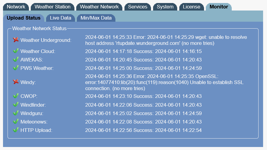

What does "Monitoring - Upload Status" tell in regard to Windy?
These are appearing
Screenshot 2024-06-01 at 14-26-31 Meteobridge.png (64.82 KiB) Viewed 4742 times
I don't have this HW platform for testing here. When you give me remote login, I can try to solve this.
