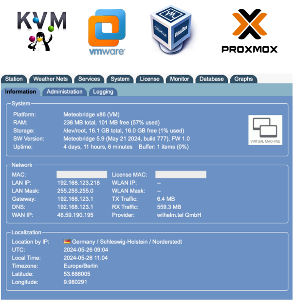

Finally Meteobridge VM is there!
Now you can have Meteobridge running without dedicated HW. Simply install the Meteobridge VM image on your virtualization platform of choice. Meteobridge VM is x86_64 based and is tested on VirtualBox, VMware Player, KVM and PROXMOX. You find details and installation instructions here.
vm bundle.png (173.81 KiB) Viewed 11667 times

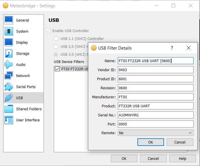

Please make sure that you select "USB 3.0" as USB mode when using VirtualBox. Otherwise VirtualBox freezes when you feed USB data into your Meteobridge VM.

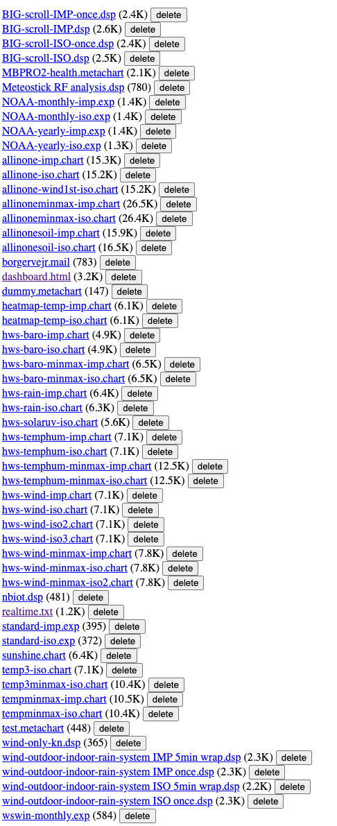

Thank you, i only see these attached files. Can I edit the language of the template I used there?
Captura de pantalla 2024-07-04 a la(s) 9.32.24 p.m..png (249.53 KiB) Viewed 11154 times
Posts: 1486
Re: Meteobridge VM
I've never changed the actually language but they are only text files so don't see why not?
I would download the standard/default template/file you want to change (click on the actual file as highlighted and copy/paste/save as)) to an new appropriate name of your choice, do your editing, then upload back. If you were to simply edit an existing default filename then next firmware update would overwrite it back to default. The file you rename/edit/upload and save won't be overwritten next update.
