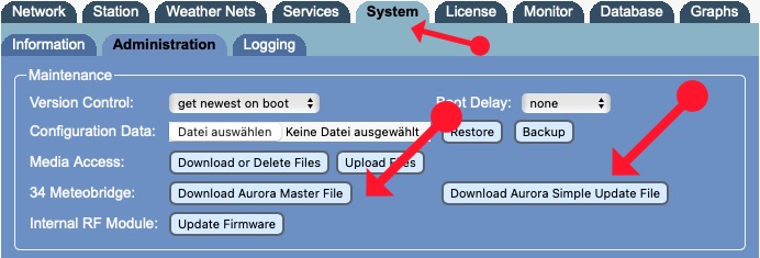

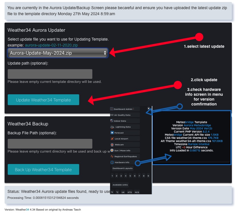

May Update has been upload and accessible via meteobridge admin screen.
to update simple follow below once uploaded to your server where template resides.

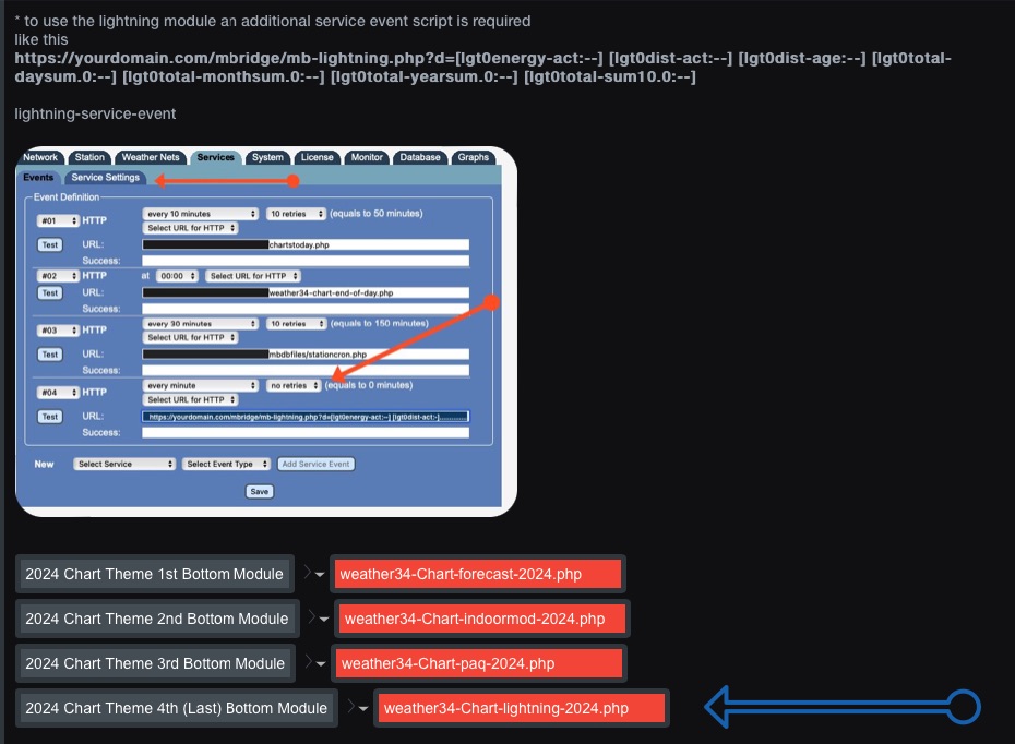

May update contains new lightning module for theme 8/9 and adds functional chart display for lightning .
* to use the lightning module for ecowitt devices an additional service event script can be used and shown below .
like this.(this is also visible in the template setup screen.
https://yourdomain.com/mbridge/mb-lightning.php?d=[lgt0energy-act:--] [lgt0dist-act:--] [lgt0dist-age:--] [lgt0total-daysum.0:--] [lgt0total-monthsum.0:--] [lgt0total-yearsum.0:--] [lgt0total-sum10.0:--]

Thanks for your help with the ecowitt lightening module. I have added the GW1000 unit as a second weather station. I have also mapped in the 3 lightening sensors. It appears to be pulling in some lightening energy data, so I can only assume the ecowitt is connected to the Nano SD.
I have setup the event setting in MB exactly as you have set out, updating the URL to where his template is stored on his host. I have it setup to run every minute.
I am not sure exactly how it works, but there is no mb-lightening.php file created, and the module on the website does not update.
Is there something I am doing wrong?

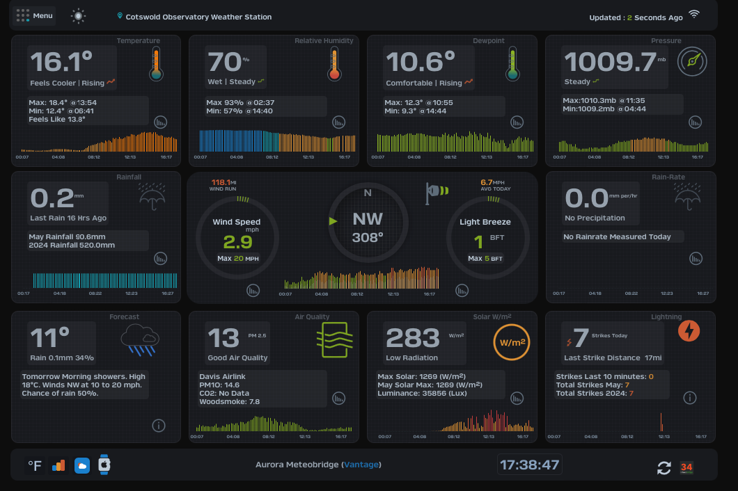

hello paul i have temporary set the lightning module in theme 9 on your site to test .if you can leave it for a day or so so i can confirm all ok.
if you can email meteobridge login admin details so i can check whats going on..
.brian

Thanks so much for helping out so quickly. It is actually for a local weather station owner and not me
https://www.cotswoldobservatory.co.uk/W ... yout-3.php
I have just emailed over all the details that I think you need.
I am off to the Netherlands this evening for a week so maybe limitted in what I can do remotely.
Thanks you
Paul

hello paul should be fine now ...https://www.cotswoldobservatory.co.uk/W ... yout-3.php
let it run for a few days ..
see below
Screenshot at May 29 19-38-53.png (244.09 KiB) Viewed 10150 times
