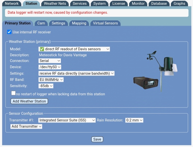

I'm trying to connect the Meteobridge Pro 2 and Vantage Pro 2 to be able to upload my data to various sites without having to run a computer.
I have the Meteobridge set to use internal RF receiver, UK RF band, Transmitter #1 ISS. I've tried all the other combinations too.
The Vantage Pro 2 is on the default transmitter setting and the data is being received by a Vantage Vue console.
The Meteobridge Pro 2 can receive retransmitted data from the Vantage Vue console.
I've tried sensitivity from -95dB to -30dB.
The distance from the Meteobridge Pro 2 to the Vantage Pro 2 is about 10m/30ft through a double glazed window.
Any thoughts?

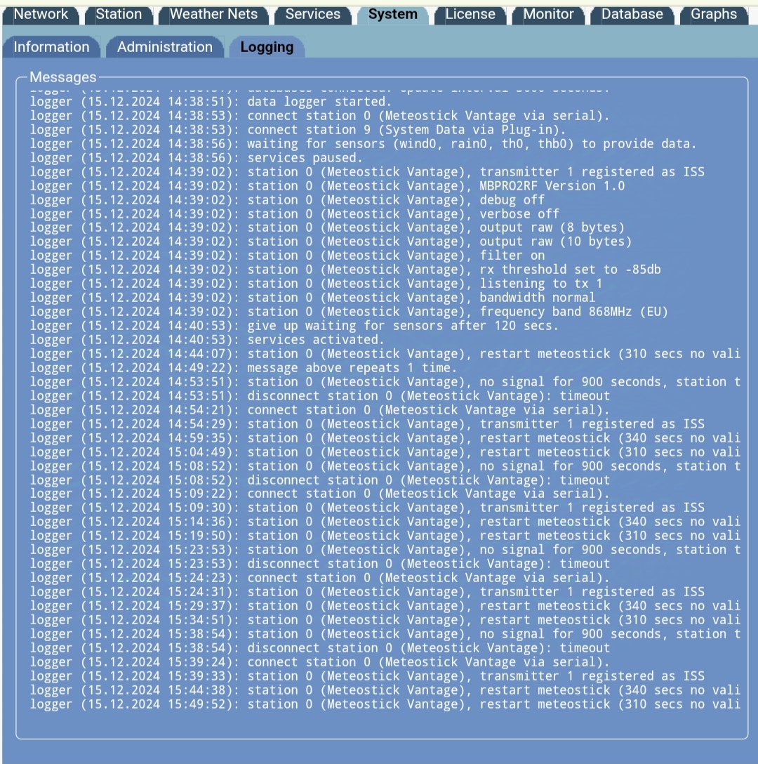

- IMG_20241216_094144.jpg (124.46 KiB) Viewed 3069 times
- IMG_20241215_155316.jpg (584.83 KiB) Viewed 3111 times
- IMG_20241215_155346.jpg (89.35 KiB) Viewed 3111 times

Thanks for the reply
I notice that I put UK RF band which should be EU RF band.
All bought in the UK from a Davis UK dealer. The Vantage Vue was bought about 9 years ago and the Vantage Pro 2 and Meteobridge Pro 2 were bought last week.
I've tried [receive RF data directly (narrow bandwidth)] when I was going through the range of sensitivity settings.
The Vue console received data directly from the new Vantage Pro without any change of settings.

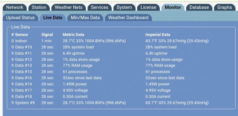

I've assumed that my VP2 transmits on European frequency but I don't know how to prove it other than to check the label attached to it which I'll do in the morning. Data from the VP2 is received by the Vue console.
I'm sure the MBPRO2 is working correctly, I removed the battery from the old Vue ISS last week as data from it was received by the MBPRO2.
I've set the MBPRO2 to narrow bandwidth and run through various sensitivity settings at 3 minute intervals. Lastly I set all the transmitters to ISS.
Log posted below.
_-----------_---------_-------
logger (16.12.2024 03:47:52): message above repeats 1 time.
system (16.12.2024 03:50:40): stop of logging process initiated.
logger (16.12.2024 03:50:40): parent process received termination signal (15).
logger (16.12.2024 03:50:40): child process received termination signal (15).
logger (16.12.2024 03:50:40): disconnect station 0 (Meteostick Vantage): exit
logger (16.12.2024 03:50:40): disconnect station 9 (System Data): exit
system (16.12.2024 03:50:44): start of logging process initiated.
logger (16.12.2024 03:50:44): databases connected. Update interval 3600 seconds.
logger (16.12.2024 03:50:44): data logger started.
logger (16.12.2024 03:50:46): connect station 0 (Meteostick Vantage via serial).
logger (16.12.2024 03:50:46): connect station 9 (System Data via Plug-in).
logger (16.12.2024 03:50:49): waiting for sensors (wind0, rain0, th0, thb0) to provide data.
logger (16.12.2024 03:50:49): services paused.
logger (16.12.2024 03:50:55): station 0 (Meteostick Vantage), transmitter 1 registered as ISS
logger (16.12.2024 03:50:55): station 0 (Meteostick Vantage), MBPRO2RF Version 1.0
logger (16.12.2024 03:50:55): station 0 (Meteostick Vantage), debug off
logger (16.12.2024 03:50:55): station 0 (Meteostick Vantage), verbose off
logger (16.12.2024 03:50:55): station 0 (Meteostick Vantage), output raw (8 bytes)
logger (16.12.2024 03:50:55): station 0 (Meteostick Vantage), output raw (10 bytes)
logger (16.12.2024 03:50:55): station 0 (Meteostick Vantage), filter on
logger (16.12.2024 03:50:55): station 0 (Meteostick Vantage), rx threshold set to -85db
logger (16.12.2024 03:50:55): station 0 (Meteostick Vantage), listening to tx 1
logger (16.12.2024 03:50:55): station 0 (Meteostick Vantage), bandwidth narrow
logger (16.12.2024 03:50:55): station 0 (Meteostick Vantage), frequency band 868MHz (EU)
logger (16.12.2024 03:52:46): give up waiting for sensors after 120 secs.
logger (16.12.2024 03:52:46): services activated.
system (16.12.2024 03:53:20): stop of logging process initiated.
logger (16.12.2024 03:53:20): parent process received termination signal (15).
logger (16.12.2024 03:53:20): child process received termination signal (15).
logger (16.12.2024 03:53:20): disconnect station 0 (Meteostick Vantage): exit
logger (16.12.2024 03:53:20): disconnect station 9 (System Data): exit
system (16.12.2024 03:53:23): start of logging process initiated.
logger (16.12.2024 03:53:23): databases connected. Update interval 3600 seconds.
logger (16.12.2024 03:53:23): data logger started.
logger (16.12.2024 03:53:25): connect station 0 (Meteostick Vantage via serial).
logger (16.12.2024 03:53:25): connect station 9 (System Data via Plug-in).
logger (16.12.2024 03:53:28): waiting for sensors (wind0, rain0, th0, thb0) to provide data.
logger (16.12.2024 03:53:28): services paused.
logger (16.12.2024 03:53:34): station 0 (Meteostick Vantage), transmitter 1 registered as ISS
logger (16.12.2024 03:53:34): station 0 (Meteostick Vantage), MBPRO2RF Version 1.0
logger (16.12.2024 03:53:34): station 0 (Meteostick Vantage), debug off
logger (16.12.2024 03:53:34): station 0 (Meteostick Vantage), verbose off
logger (16.12.2024 03:53:34): station 0 (Meteostick Vantage), output raw (8 bytes)
logger (16.12.2024 03:53:34): station 0 (Meteostick Vantage), output raw (10 bytes)
logger (16.12.2024 03:53:34): station 0 (Meteostick Vantage), filter on
logger (16.12.2024 03:53:34): station 0 (Meteostick Vantage), rx threshold set to -75db
logger (16.12.2024 03:53:34): station 0 (Meteostick Vantage), listening to tx 1
logger (16.12.2024 03:53:34): station 0 (Meteostick Vantage), bandwidth narrow
logger (16.12.2024 03:53:34): station 0 (Meteostick Vantage), frequency band 868MHz (EU)
logger (16.12.2024 03:55:25): give up waiting for sensors after 120 secs.
logger (16.12.2024 03:55:25): services activated.
system (16.12.2024 03:56:25): stop of logging process initiated.
logger (16.12.2024 03:56:25): parent process received termination signal (15).
logger (16.12.2024 03:56:25): child process received termination signal (15).
logger (16.12.2024 03:56:25): disconnect station 0 (Meteostick Vantage): exit
logger (16.12.2024 03:56:25): disconnect station 9 (System Data): exit
system (16.12.2024 03:56:28): start of logging process initiated.
logger (16.12.2024 03:56:29): databases connected. Update interval 3600 seconds.
logger (16.12.2024 03:56:29): data logger started.
logger (16.12.2024 03:56:30): connect station 0 (Meteostick Vantage via serial).
logger (16.12.2024 03:56:30): connect station 9 (System Data via Plug-in).
logger (16.12.2024 03:56:33): waiting for sensors (wind0, rain0, th0, thb0) to provide data.
logger (16.12.2024 03:56:33): services paused.
logger (16.12.2024 03:56:39): station 0 (Meteostick Vantage), transmitter 1 registered as ISS
logger (16.12.2024 03:56:39): station 0 (Meteostick Vantage), MBPRO2RF Version 1.0
logger (16.12.2024 03:56:39): station 0 (Meteostick Vantage), debug off
logger (16.12.2024 03:56:39): station 0 (Meteostick Vantage), verbose off
logger (16.12.2024 03:56:39): station 0 (Meteostick Vantage), output raw (8 bytes)
logger (16.12.2024 03:56:39): station 0 (Meteostick Vantage), output raw (10 bytes)
logger (16.12.2024 03:56:39): station 0 (Meteostick Vantage), filter on
logger (16.12.2024 03:56:39): station 0 (Meteostick Vantage), rx threshold set to -65db
logger (16.12.2024 03:56:39): station 0 (Meteostick Vantage), listening to tx 1
logger (16.12.2024 03:56:39): station 0 (Meteostick Vantage), bandwidth narrow
logger (16.12.2024 03:56:39): station 0 (Meteostick Vantage), frequency band 868MHz (EU)
nbiot (16.12.2024 03:57:16): module reset failed
logger (16.12.2024 03:58:30): give up waiting for sensors after 120 secs.
logger (16.12.2024 03:58:30): services activated.
system (16.12.2024 03:59:40): stop of logging process initiated.
logger (16.12.2024 03:59:40): parent process received termination signal (15).
logger (16.12.2024 03:59:40): child process received termination signal (15).
logger (16.12.2024 03:59:40): disconnect station 0 (Meteostick Vantage): exit
logger (16.12.2024 03:59:40): disconnect station 9 (System Data): exit
system (16.12.2024 03:59:43): start of logging process initiated.
logger (16.12.2024 03:59:43): databases connected. Update interval 3600 seconds.
logger (16.12.2024 03:59:43): data logger started.
logger (16.12.2024 03:59:45): connect station 0 (Meteostick Vantage via serial).
logger (16.12.2024 03:59:45): connect station 9 (System Data via Plug-in).
logger (16.12.2024 03:59:48): waiting for sensors (wind0, rain0, th0, thb0) to provide data.
logger (16.12.2024 03:59:48): services paused.
logger (16.12.2024 03:59:54): station 0 (Meteostick Vantage), transmitter 1 registered as ISS
logger (16.12.2024 03:59:54): station 0 (Meteostick Vantage), MBPRO2RF Version 1.0
logger (16.12.2024 03:59:54): station 0 (Meteostick Vantage), debug off
logger (16.12.2024 03:59:54): station 0 (Meteostick Vantage), verbose off
logger (16.12.2024 03:59:54): station 0 (Meteostick Vantage), output raw (8 bytes)
logger (16.12.2024 03:59:54): station 0 (Meteostick Vantage), output raw (10 bytes)
logger (16.12.2024 03:59:54): station 0 (Meteostick Vantage), filter on
logger (16.12.2024 03:59:54): station 0 (Meteostick Vantage), rx threshold set to -55db
logger (16.12.2024 03:59:54): station 0 (Meteostick Vantage), listening to tx 1
logger (16.12.2024 03:59:54): station 0 (Meteostick Vantage), bandwidth narrow
logger (16.12.2024 03:59:54): station 0 (Meteostick Vantage), frequency band 868MHz (EU)
logger (16.12.2024 04:01:45): give up waiting for sensors after 120 secs.
logger (16.12.2024 04:01:45): services activated.
system (16.12.2024 04:03:33): stop of logging process initiated.
logger (16.12.2024 04:03:33): parent process received termination signal (15).
logger (16.12.2024 04:03:33): child process received termination signal (15).
logger (16.12.2024 04:03:33): disconnect station 0 (Meteostick Vantage): exit
logger (16.12.2024 04:03:33): disconnect station 9 (System Data): exit
system (16.12.2024 04:03:36): start of logging process initiated.
logger (16.12.2024 04:03:37): databases connected. Update interval 3600 seconds.
logger (16.12.2024 04:03:37): data logger started.
logger (16.12.2024 04:03:38): connect station 0 (Meteostick Vantage via serial).
logger (16.12.2024 04:03:38): connect station 9 (System Data via Plug-in).
logger (16.12.2024 04:03:41): waiting for sensors (wind0, rain0, th0, thb0) to provide data.
logger (16.12.2024 04:03:41): services paused.
logger (16.12.2024 04:03:47): station 0 (Meteostick Vantage), transmitter 1 registered as ISS
logger (16.12.2024 04:03:47): station 0 (Meteostick Vantage), MBPRO2RF Version 1.0
logger (16.12.2024 04:03:47): station 0 (Meteostick Vantage), debug off
logger (16.12.2024 04:03:47): station 0 (Meteostick Vantage), verbose off
logger (16.12.2024 04:03:47): station 0 (Meteostick Vantage), output raw (8 bytes)
logger (16.12.2024 04:03:47): station 0 (Meteostick Vantage), output raw (10 bytes)
logger (16.12.2024 04:03:47): station 0 (Meteostick Vantage), filter on
logger (16.12.2024 04:03:47): station 0 (Meteostick Vantage), rx threshold set to -45db
logger (16.12.2024 04:03:47): station 0 (Meteostick Vantage), listening to tx 1
logger (16.12.2024 04:03:47): station 0 (Meteostick Vantage), bandwidth narrow
logger (16.12.2024 04:03:47): station 0 (Meteostick Vantage), frequency band 868MHz (EU)
logger (16.12.2024 04:05:38): give up waiting for sensors after 120 secs.
logger (16.12.2024 04:05:38): services activated.
system (16.12.2024 04:06:27): stop of logging process initiated.
logger (16.12.2024 04:06:27): parent process received termination signal (15).
logger (16.12.2024 04:06:27): child process received termination signal (15).
logger (16.12.2024 04:06:27): disconnect station 0 (Meteostick Vantage): exit
logger (16.12.2024 04:06:27): disconnect station 9 (System Data): exit
system (16.12.2024 04:06:30): start of logging process initiated.
logger (16.12.2024 04:06:30): databases connected. Update interval 3600 seconds.
logger (16.12.2024 04:06:30): data logger started.
logger (16.12.2024 04:06:32): connect station 0 (Meteostick Vantage via serial).
logger (16.12.2024 04:06:32): connect station 9 (System Data via Plug-in).
logger (16.12.2024 04:06:35): waiting for sensors (wind0, rain0, th0, thb0) to provide data.
logger (16.12.2024 04:06:35): services paused.
logger (16.12.2024 04:06:41): station 0 (Meteostick Vantage), transmitter 1 registered as ISS
logger (16.12.2024 04:06:41): station 0 (Meteostick Vantage), MBPRO2RF Version 1.0
logger (16.12.2024 04:06:41): station 0 (Meteostick Vantage), debug off
logger (16.12.2024 04:06:41): station 0 (Meteostick Vantage), verbose off
logger (16.12.2024 04:06:41): station 0 (Meteostick Vantage), output raw (8 bytes)
logger (16.12.2024 04:06:41): station 0 (Meteostick Vantage), output raw (10 bytes)
logger (16.12.2024 04:06:41): station 0 (Meteostick Vantage), filter on
logger (16.12.2024 04:06:41): station 0 (Meteostick Vantage), rx threshold set to -35db
logger (16.12.2024 04:06:41): station 0 (Meteostick Vantage), listening to tx 1
logger (16.12.2024 04:06:41): station 0 (Meteostick Vantage), bandwidth narrow
logger (16.12.2024 04:06:41): station 0 (Meteostick Vantage), frequency band 868MHz (EU)
logger (16.12.2024 04:08:32): give up waiting for sensors after 120 secs.
logger (16.12.2024 04:08:32): services activated.
system (16.12.2024 04:09:44): stop of logging process initiated.
logger (16.12.2024 04:09:44): parent process received termination signal (15).
logger (16.12.2024 04:09:44): child process received termination signal (15).
logger (16.12.2024 04:09:44): disconnect station 0 (Meteostick Vantage): exit
logger (16.12.2024 04:09:45): disconnect station 9 (System Data): exit
system (16.12.2024 04:09:48): start of logging process initiated.
logger (16.12.2024 04:09:48): databases connected. Update interval 3600 seconds.
logger (16.12.2024 04:09:48): data logger started.
logger (16.12.2024 04:09:50): connect station 0 (Meteostick Vantage via serial).
logger (16.12.2024 04:09:50): connect station 9 (System Data via Plug-in).
logger (16.12.2024 04:09:53): waiting for sensors (wind0, rain0, th0, thb0) to provide data.
logger (16.12.2024 04:09:53): services paused.
logger (16.12.2024 04:09:59): station 0 (Meteostick Vantage), transmitter 1 registered as ISS
logger (16.12.2024 04:09:59): station 0 (Meteostick Vantage), MBPRO2RF Version 1.0
logger (16.12.2024 04:09:59): station 0 (Meteostick Vantage), debug off
logger (16.12.2024 04:09:59): station 0 (Meteostick Vantage), verbose off
logger (16.12.2024 04:09:59): station 0 (Meteostick Vantage), output raw (8 bytes)
logger (16.12.2024 04:09:59): station 0 (Meteostick Vantage), output raw (10 bytes)
logger (16.12.2024 04:09:59): station 0 (Meteostick Vantage), filter on
logger (16.12.2024 04:09:59): station 0 (Meteostick Vantage), rx threshold set to -30db
logger (16.12.2024 04:09:59): station 0 (Meteostick Vantage), listening to tx 1
logger (16.12.2024 04:09:59): station 0 (Meteostick Vantage), bandwidth narrow
logger (16.12.2024 04:09:59): station 0 (Meteostick Vantage), frequency band 868MHz (EU)
logger (16.12.2024 04:11:50): give up waiting for sensors after 120 secs.
logger (16.12.2024 04:11:50): services activated.
system (16.12.2024 04:13:22): stop of logging process initiated.
logger (16.12.2024 04:13:22): parent process received termination signal (15).
logger (16.12.2024 04:13:22): child process received termination signal (15).
logger (16.12.2024 04:13:22): disconnect station 0 (Meteostick Vantage): exit
logger (16.12.2024 04:13:22): disconnect station 9 (System Data): exit
system (16.12.2024 04:13:25): start of logging process initiated.
logger (16.12.2024 04:13:25): databases connected. Update interval 3600 seconds.
logger (16.12.2024 04:13:25): data logger started.
logger (16.12.2024 04:13:27): connect station 0 (Meteostick Vantage via serial).
logger (16.12.2024 04:13:27): connect station 9 (System Data via Plug-in).
logger (16.12.2024 04:13:30): waiting for sensors (wind0, rain0, th0, thb0) to provide data.
logger (16.12.2024 04:13:30): services paused.
logger (16.12.2024 04:13:36): station 0 (Meteostick Vantage), transmitter 1 registered as ISS
logger (16.12.2024 04:13:36): station 0 (Meteostick Vantage), MBPRO2RF Version 1.0
logger (16.12.2024 04:13:36): station 0 (Meteostick Vantage), debug off
logger (16.12.2024 04:13:36): station 0 (Meteostick Vantage), verbose off
logger (16.12.2024 04:13:36): station 0 (Meteostick Vantage), output raw (8 bytes)
logger (16.12.2024 04:13:36): station 0 (Meteostick Vantage), output raw (10 bytes)
logger (16.12.2024 04:13:36): station 0 (Meteostick Vantage), filter on
logger (16.12.2024 04:13:36): station 0 (Meteostick Vantage), rx threshold set to -85db
logger (16.12.2024 04:13:36): station 0 (Meteostick Vantage), listening to tx 1
logger (16.12.2024 04:13:36): station 0 (Meteostick Vantage), bandwidth narrow
logger (16.12.2024 04:13:36): station 0 (Meteostick Vantage), frequency band 868MHz (EU)
system (16.12.2024 04:15:13): stop of logging process initiated.
logger (16.12.2024 04:15:13): parent process received termination signal (15).
logger (16.12.2024 04:15:13): child process received termination signal (15).
logger (16.12.2024 04:15:13): disconnect station 0 (Meteostick Vantage): exit
logger (16.12.2024 04:15:13): disconnect station 9 (System Data): exit
system (16.12.2024 04:15:16): start of logging process initiated.
logger (16.12.2024 04:15:16): databases connected. Update interval 3600 seconds.
logger (16.12.2024 04:15:16): data logger started.
logger (16.12.2024 04:15:18): connect station 0 (Meteostick Vantage via serial).
logger (16.12.2024 04:15:18): connect station 9 (System Data via Plug-in).
logger (16.12.2024 04:15:21): waiting for sensors (wind0, rain0, th0, thb0) to provide data.
logger (16.12.2024 04:15:21): services paused.
logger (16.12.2024 04:15:27): station 0 (Meteostick Vantage), transmitter 1 registered as ISS
logger (16.12.2024 04:15:27): station 0 (Meteostick Vantage), transmitter 2 registered as ISS
logger (16.12.2024 04:15:27): station 0 (Meteostick Vantage), transmitter 3 registered as ISS
logger (16.12.2024 04:15:27): station 0 (Meteostick Vantage), transmitter 4 registered as ISS
logger (16.12.2024 04:15:27): station 0 (Meteostick Vantage), transmitter 5 registered as ISS
logger (16.12.2024 04:15:27): station 0 (Meteostick Vantage), transmitter 6 registered as ISS
logger (16.12.2024 04:15:27): station 0 (Meteostick Vantage), transmitter 7 registered as ISS
logger (16.12.2024 04:15:27): station 0 (Meteostick Vantage), transmitter 8 registered as ISS
logger (16.12.2024 04:15:27): station 0 (Meteostick Vantage), MBPRO2RF Version 1.0
logger (16.12.2024 04:15:27): station 0 (Meteostick Vantage), debug off
logger (16.12.2024 04:15:27): station 0 (Meteostick Vantage), verbose off
logger (16.12.2024 04:15:27): station 0 (Meteostick Vantage), output raw (8 bytes)
logger (16.12.2024 04:15:27): station 0 (Meteostick Vantage), output raw (10 bytes)
logger (16.12.2024 04:15:27): station 0 (Meteostick Vantage), filter on
logger (16.12.2024 04:15:27): station 0 (Meteostick Vantage), rx threshold set to -85db
logger (16.12.2024 04:15:27): station 0 (Meteostick Vantage), listening to tx 1 2 3 4 5 6 7 8
logger (16.12.2024 04:15:27): station 0 (Meteostick Vantage), bandwidth narrow
logger (16.12.2024 04:15:27): station 0 (Meteostick Vantage), frequency band 868MHz (EU)
logger (16.12.2024 04:17:18): give up waiting for sensors after 120 secs.
logger (16.12.2024 04:17:18): services activated.
Log posted below.
Re: Meteobridge Pro 2 unable to connect to Vantage Pro 2
On the Vue Console press DONE and cursor "+" keys at the same time.
Will show REV x.xx, then (Freq Band) then Language
[Ok so the 9 year old Vantage Vue talks to the VP2 bought just last week but the MBPro2 won't talk to the VP2 bought just last week?]
That's correct.
From the Vue console:-
4.18
EU
English
That's correct.
4.18
EU
English
I looked for confirmation that it's a EU version but I can't see a label on the weather station or the box.
The model number is 6322OV.
The VUE console says EU so it is EU.
Otherwise I don't see anything that stands out. I updated an MBPro2 to your same FW version and it's working as expected. The only two(2) things I can see in the logs that are different are your log shows MBOPRO2RF version 1.0 and this one here says METEOSTICK version 1.0 and I am running -80db
Obviously something different here somewhere? Boris probably needs to have a look at this one.
Thanks for looking.
I've changed my sensitivity from -85 to -80dB so it's the same as yours.
I've been running off a USB PSU but I'm now using the mains PSU so I can leave it running 24/7.
Hopefully Boris will have some time available to take a look.
