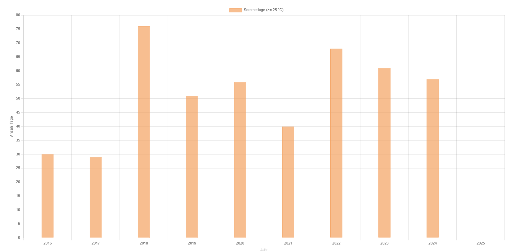

At the request of a member, I am sharing my PHP script, which generates a chart displaying weather-related events, such as the number of summer days (days with a maximum temperature of at least 25°C) per year over multiple years.
http://www.wetter-keppeln.de/sommertage.html

Questions & Notes
This script was created with the help of AI, and I am not an expert in PHP, so any suggestions for improvement are welcome! Feel free to ask if you have any questions.
Here is the PHP code for the diagram

    <h1>Summer Days (>= 25°C) Per Year</h1>
    <canvas id="barChart"></canvas>
