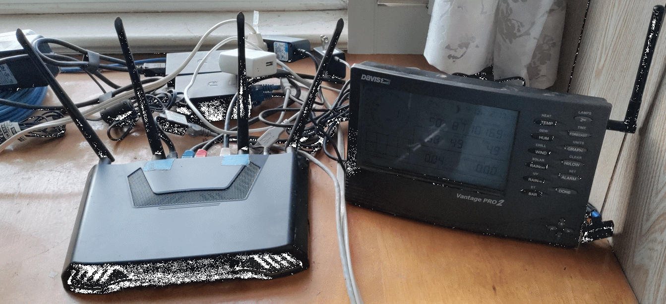

The NANO reports a 94% WiFi connection to the router (it is located about 20cm from the router).

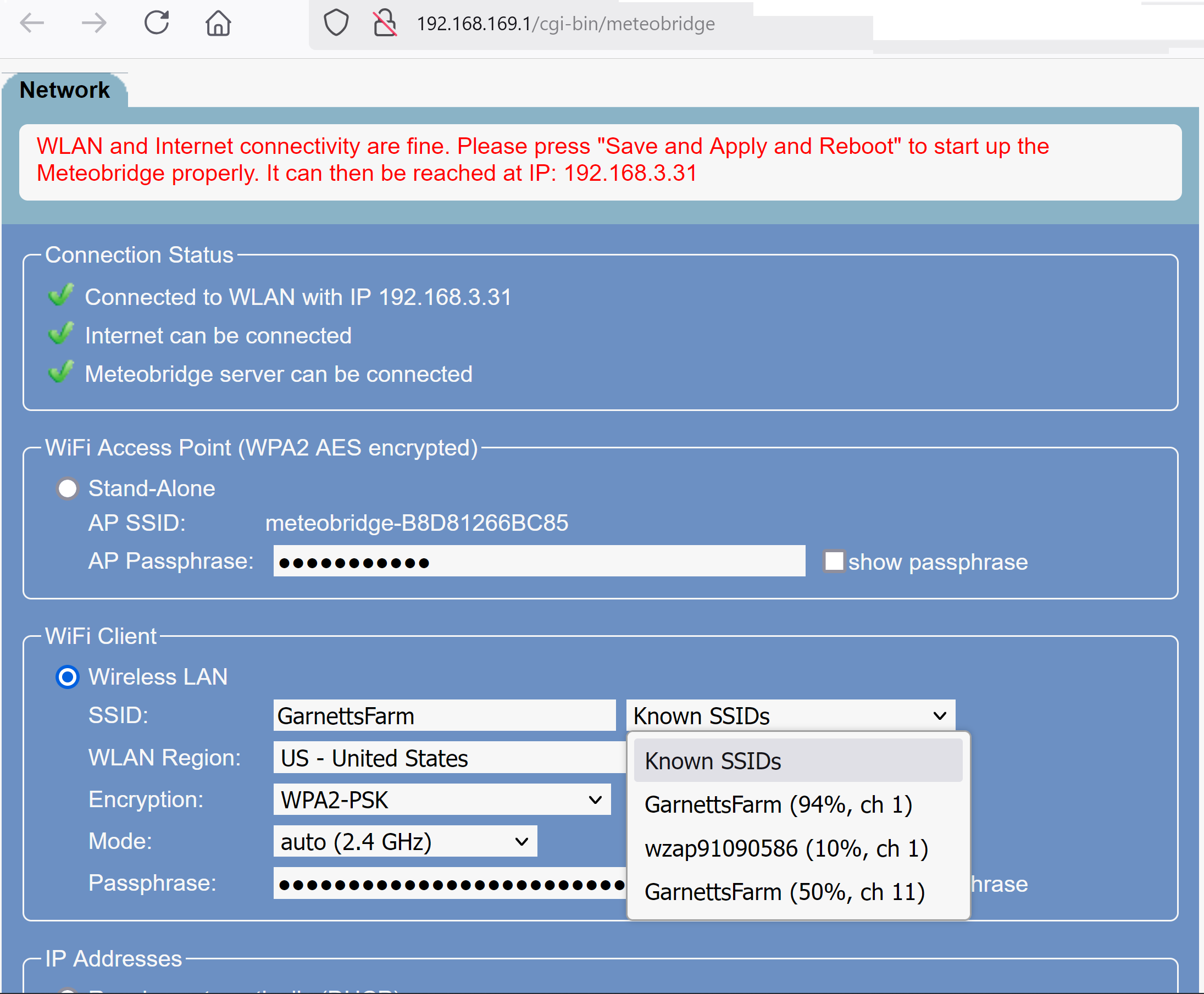

When I reconnected the NANO just now (with the 5V 2A power supply) it booted and reported its assigned IP address (192.168.3.31) by flash codes after a single press of the blue button. However it did not respond to an http request at that address. By connecting to its "meteobridge_XXXX" diagnostic WiFi, the NANO displayed its Network webpage (see attached screenshot) which said that connectivity was fine and I should Save,Apply&Reboot.

Re: NANO SD freezes on reboot, requiring power cycle
What is the other SSID #1 @ 10%? Would that be interfering? Did you try the SSID #11?

The other SSID at 10% is a WiFi-connected doorbell camera. I don't imagine it would interfere with the NANO connecting to the router, considering how much stronger the router's signal is due to its being only 15cm away from the NANO.

The red strap Nano definatley requires the extra power as was released April 20,2019. High power WiFi like the red strap Nano and being so close to the router (15cm) could also be contributing to reception anomalies?
