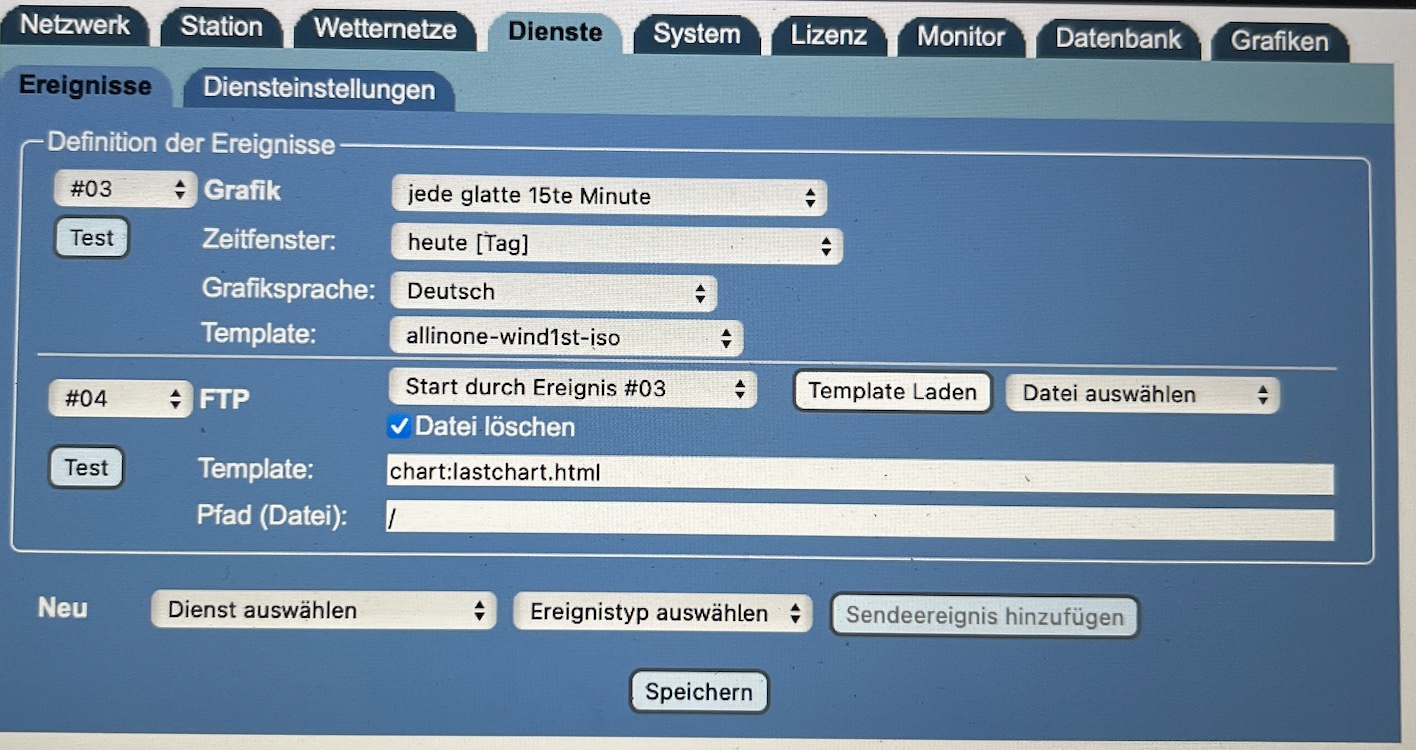

I understand that the interactive graphics can be accessed via the "remote URL" if "allow login from internet" is enabled.
Because my meteobridge is connected to the internet via a LTE connection I can not use this approach.
How can the graphs can be generated and uploaded periodically ?
I tried using two "Events", the first should create the graphics via the "allinone-wind1st-iso" template.
The second event should then transfer the chart:lastchart.html to the web server.

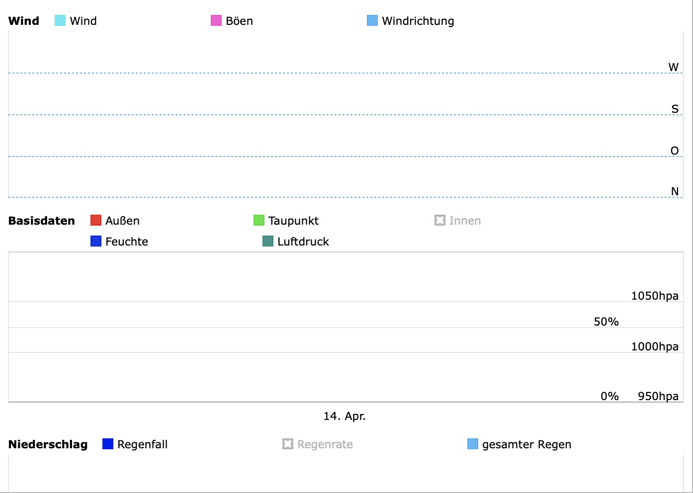

But I only see an empty graph.
What is missing there ?

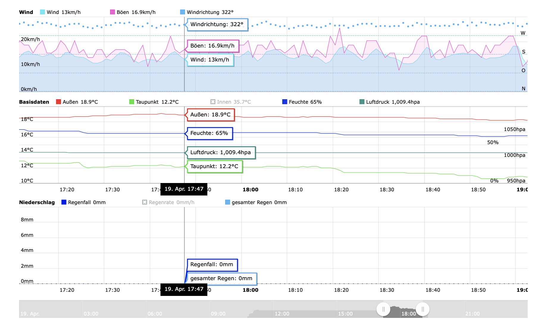

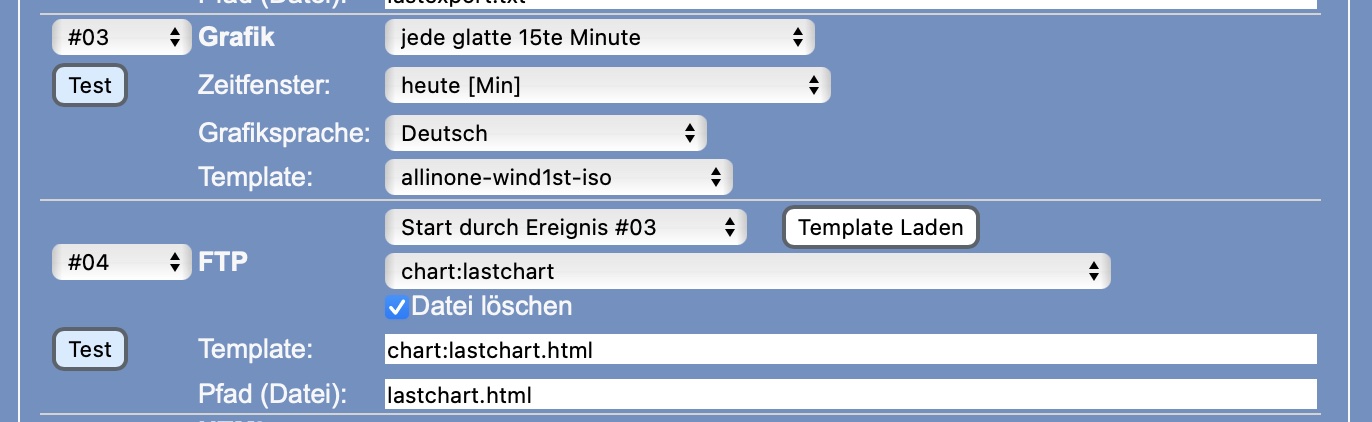

The problem was that the timeslot was wrong. With "today (Min)" or "heute (Min)" the graphic show the complete data.
(special thanks to Boris for his tipps :wink: )
