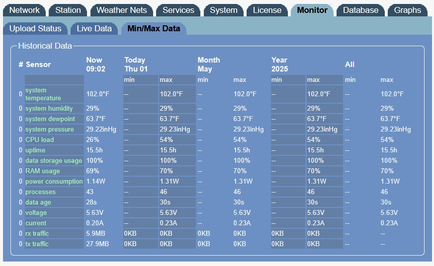

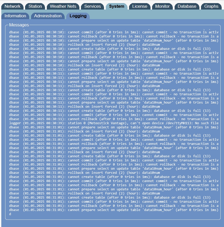

Meteobridge Pro. We had a power bump yesterday. Since then, no data is reaching the wx nets. Weather Underground & PWS weather both say they are receiving updates, but there is no data. Data is being received on my Vantage Vue & my Weatherlink console from the ISS. I have attached two screens showing errors.
- Screenshot 2025-05-01 090319.jpg (203.83 KiB) Viewed 6226 times
- Screenshot 2025-05-01 084330.jpg (677.94 KiB) Viewed 6226 times

Can you please show "System - Info" tab?
Re: Data not reaching Wx nets
Attached is the System - Info tab
In case it matters, It is connected via cable to an Eero 6 port.
- Screenshot 2025-05-02 083943.jpg (232.26 KiB) Viewed 6125 times

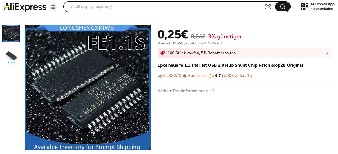

Sorry, as internal storage is no longer shown as available the Internal USB hub chip has failed. It needs to be replaced.
I would repair for free, but sending from US to Germany and back will be the issue. Do you have some electronics guy around locally who can replace a SMB IC? Item to be replaced is a FE1.1s which is a $1 piece:

It looks like I may be able to replace it myself. Is there a board layout drawing or photo available? BTW, the link you sent didn't work, but I was able to find them here with a quick search.

Here is shown how to open and close it: https://www.youtube.com/watch?v=Wn0_tM_jjZI&t=6s
You have to unsolder the OLED (which you can also replace once being there) and then you have to desolder the FE1.1s and replace with new one. When you have a rework soldering station with a hot air tube it is not too complicated.
Link to FE1.1s:
Link to OLED:
Link to FE1.1s:
Link to OLED:
