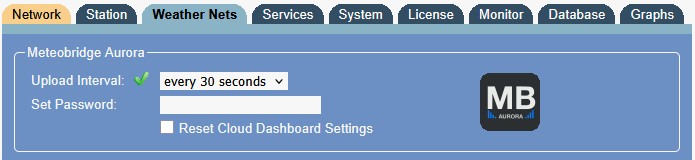

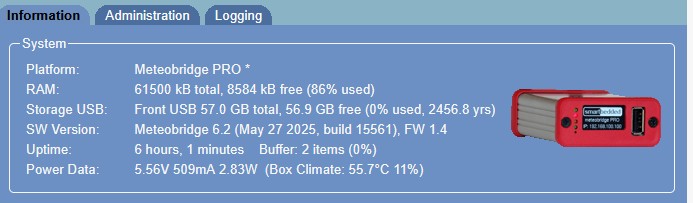

Hi
Thank you for the replies but I am a bit confused
Here is a screenshot from my Aurora dashboard in the cloud from my Pro Red and it has charts for 2025
https://content.meteobridge.com/dashboa ... charts.php
Many thanks
Graham

Re: Importing data into Aurora Cloud from Aurora setup on PC. **solved**
OK, so you have an Aurora-Dashboard somewhere on a server in the Internet (or on your PC) which received data from the MB PRO. I just wanted to pint out, that there is no Aurora dashboard on a MB PRO to avoid confusion.
Please apply the suggested options in my first post fom May 21.
