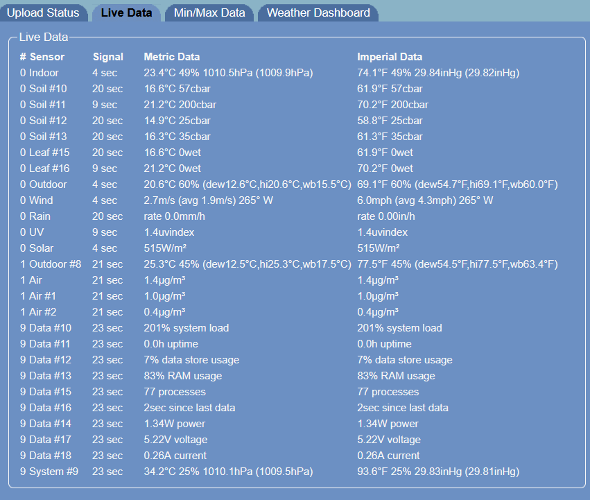

Schermafbeelding 2025-06-06 180043.png (93.79 KiB) Viewed 9729 times
I need to see 27.0°C and 42% humidity under system#9 correct?
Grtz
A
Re: I2C sht31 install
alexvanuxem wrote: Fri Jun 06, 2025 6:03 pm I need to see 27.0°C and 42% humidity under system#9 correct?
Yes, that is what I would expect to see. But your example does show different. I will check.
