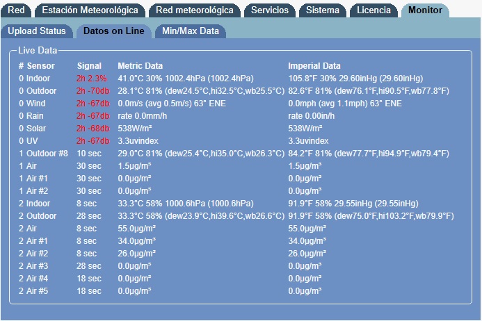

I use a TL-WR902ACV3 with Meteostick RF direct to the ISS, but it is unstable despite being close to the ISS, But the strange thing is that the MB does not sense the meteostick either.

May be the power is not enough to feed the meteostick?

Which RF threshold did you define on "Station" tab?

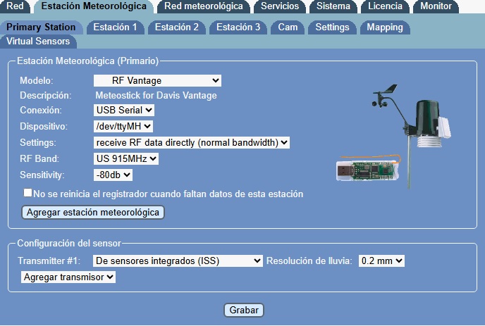

Those are my setup, the MS works fine for a few hours, later stops sense the ISS and the meteostick.

You are picking up an enormous level of RF noise (reception rate - shown beside the indoor data - is just 0.5%!!). Please set RF threshold to -80db and/or look for a better, less RF noise exposed location.

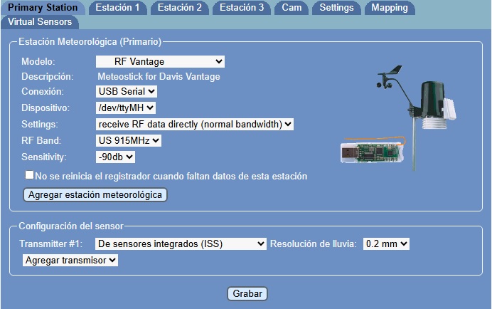

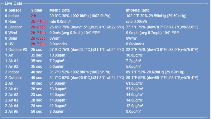

admin wrote: Wed Aug 06, 2025 4:22 pm You are picking up an enormous level of RF noise (reception rate - shown beside the indoor data - is just 0.5%!!). Please set RF threshold to -80db and/or look for a better, less RF noise exposed location.
Changed but still the same, worked for almost 4 hours.

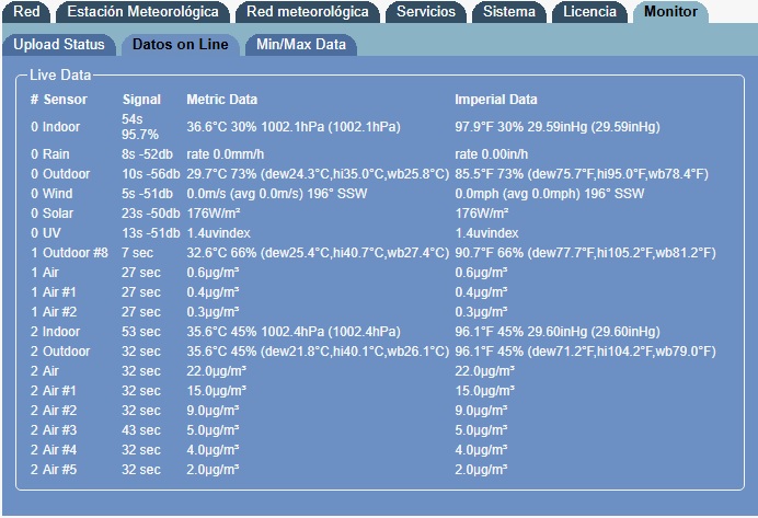

I just add an extension of USB cable and done! works fine.
