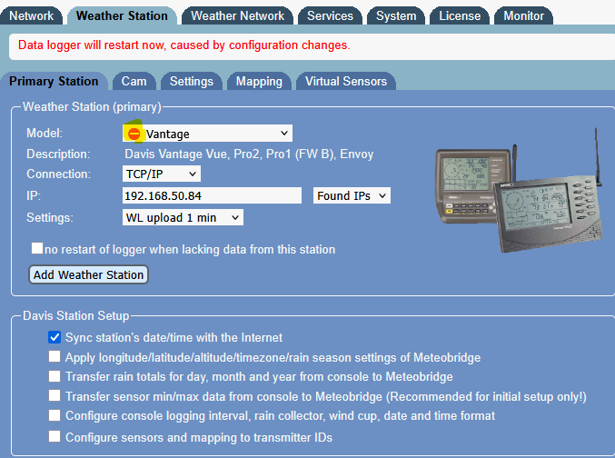

I have been using meteobridge via Raspberry Pi to send data to Weather Underground for years. WU says it was updated x minutes ago, but there is no data
Suddenly the Weather Station /Primary Station option will no longer accepts Vantage as an option.
I found new (to me) "aurora" options - I tried setting them up but the display on my PC is like Weather Underground, no data.
Thanks in advance for any insights...
Vantage PRO no longer supported?? (no data transfer). **solved**

The symbol you highlighted does not mean that. I have that symbol and my station works fine.

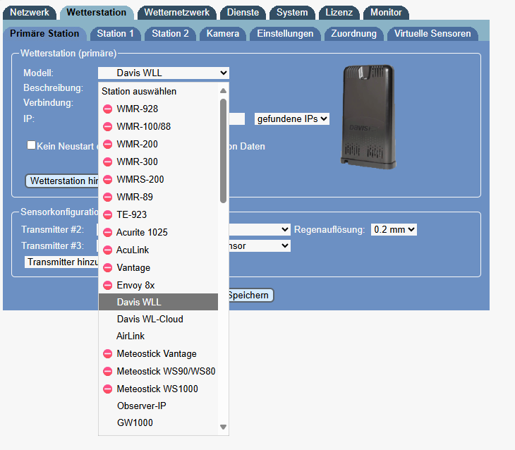

I'm uploading from WLL, Davis WL-Cloud is another option but not Vantage Pro
- WLL.png (71.76 KiB) Viewed 7310 times
Re: Vantage PRO no longer supported?? (no data transfer)
Vantage "Pro" is not an option for station choice.
Chose "Vantage" if you want to receive direct from your ISS for example through a logger attached to a console that it reads from the loggers IP address.

It just tells that there is no Davis Console or Envoy connected via USB. You can still select it and connect to it via TCP/IP if you have a WLIP installed to the Console/Envoy.HAPE wrote: Mon Aug 04, 2025 6:33 pm I'm uploading from WLL, Davis WL-Cloud is another option but not Vantage Pro

Let me wipe the egg on my face off....
As I was straightening my office a few weeks ago I accidentally dropped my console on the floor
This morning I decide to do a complete reboot which requires removing a battery from the console...I discovered that the Ethernet adapter had been jarred lose from its port I was still getting a flashing green light the adapter and was getting "updates" to Weather Underground (just time stamps, no data)
Once I put everything back together it started working as it should...many thanks to those who replied to my query
Wayne
